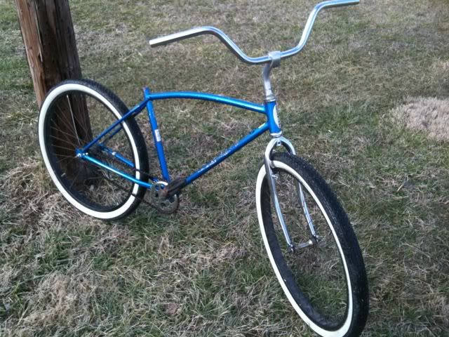

Postby kenji on Thu Mar 08, 2012 9:31 am
Here's the mockup with 26" s2 2.125's (and they rub)
frame is a $10 varsity camelback schwinn
wald bars sake MTB stem and Tange fork

Postby kenji on Thu Mar 08, 2012 9:36 am
added blue flake schwinn repop grips and built a front wheel
cream 1.95 x 26 tire
