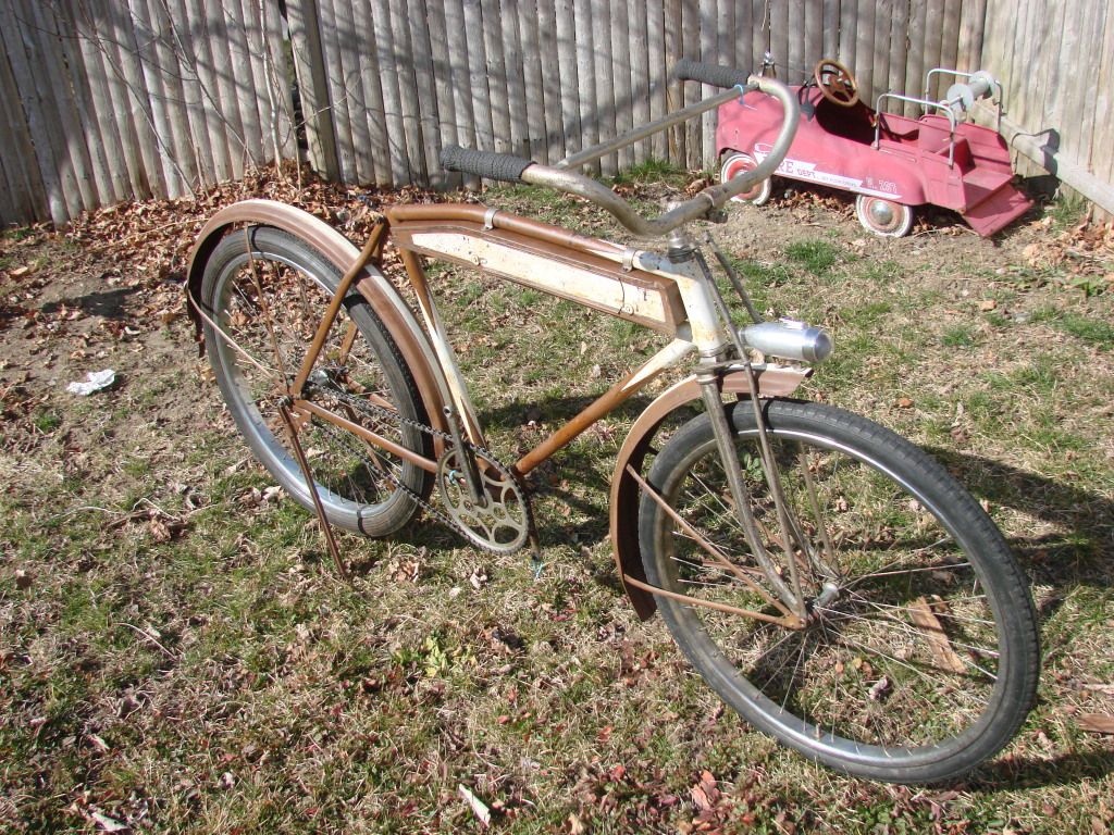

I bought this covered in gray paint..I had a hunch about this bike ..

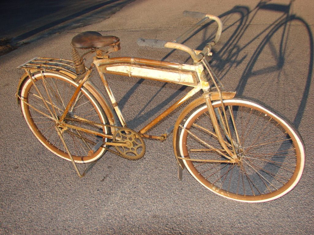

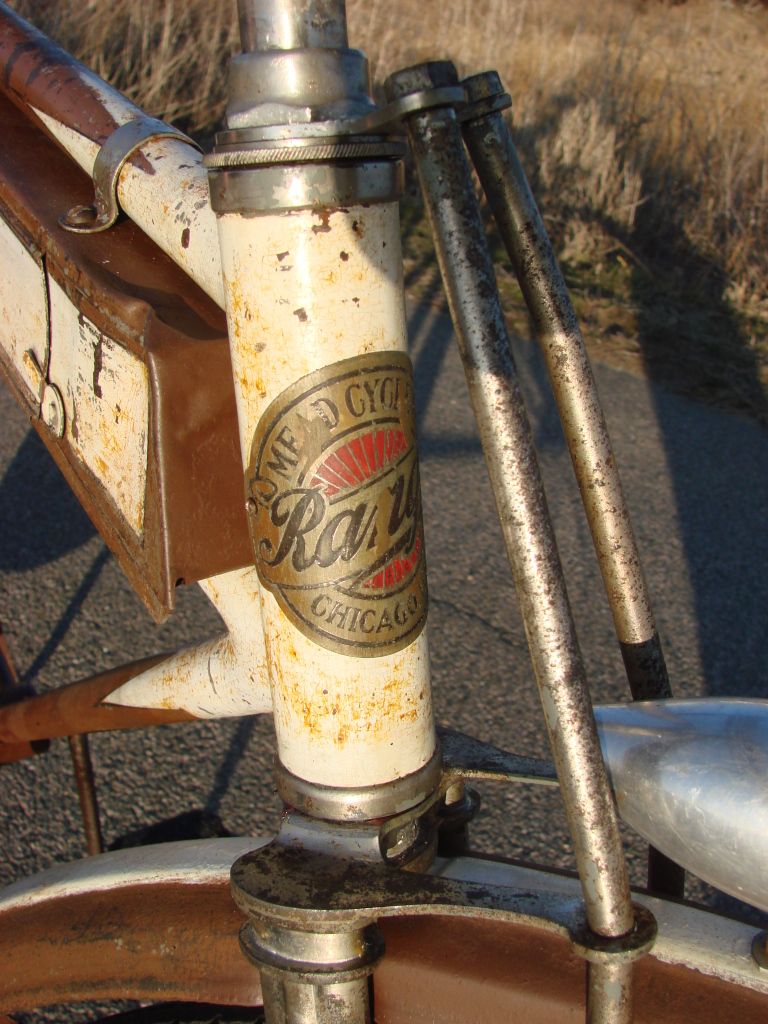

So today I removed the gray paint. This is what I had under the gray paint...
Im not done yet but man this is a lucky start..
This wont be perfect but its better than a lot of the survivor bikes like this I see on line..

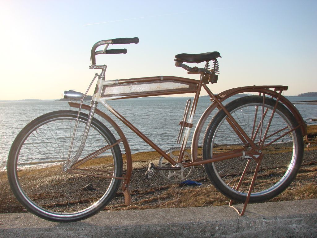

Im almost done...

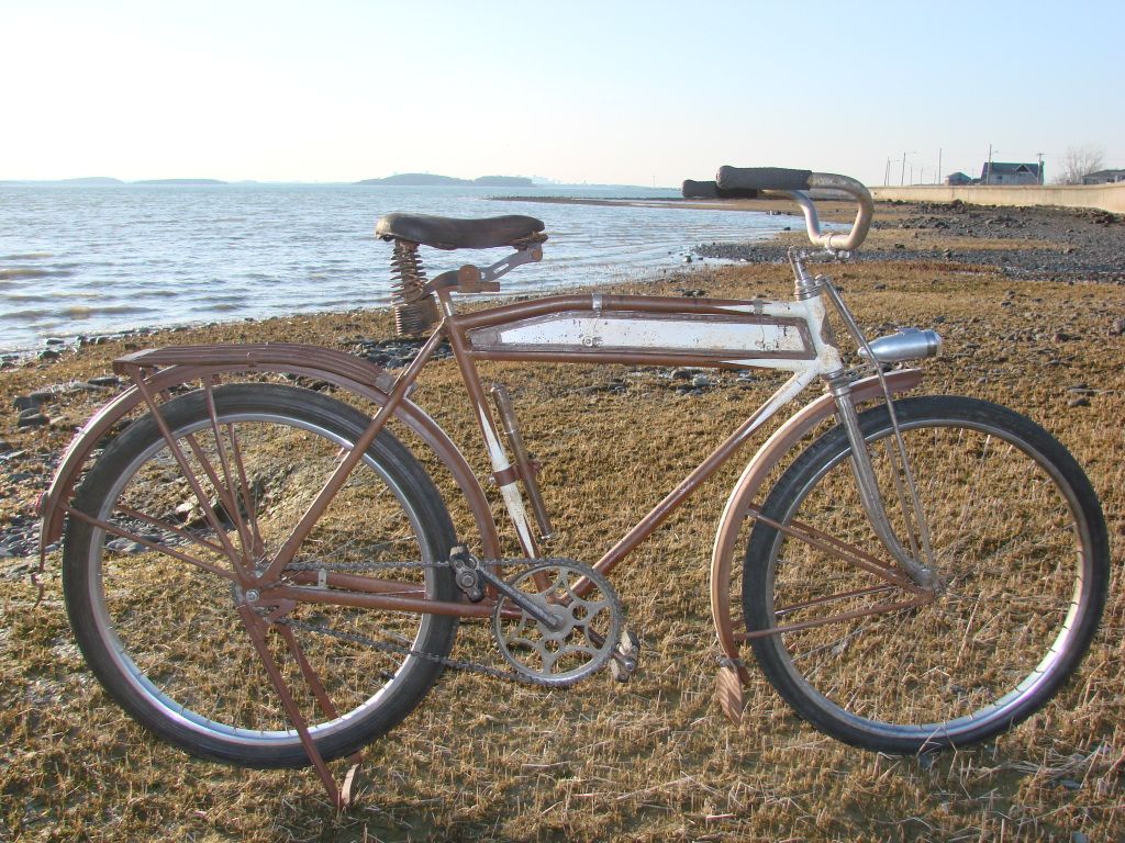

Im just about done finally .. I had no idea the fork would be nickel plated & the Pump was Brass Plated .. This bike was a suprise all the way through ..I cant even believe this is the same bike I started with .. I only replaced the Rims / Tires & The front light .. The light that came on the bike was junk inside & was not the original light.. I replaced the 28 Inch rims with 26 inch rims for now & put a big Balloon tire on the rear of the bike & a Middle weight tire on the front. Id say the paint is about 80% original I repainted the drop stand & some places on the fenders & a bit of the rear rack plus the top of the tank...I also repainted the leather mud flap..The paint is a perfect match again I was very lucky....

Holy smokes, nice! You didn't even screw with the levels in photoshop to make the first photo drab and the new one pop like they do in weight loss commercials. What technique did you go with to remove the paint?

Thanks for the comments.. :D I removed the paint using a old Credit card a bronze wool pad & a sos pad ..Very carefully it was like removing paint from a artifact ..Also I was scared to use thinner goo gone or other stuff, I did try them but the paint wasnt budging with them.. :? I was really lucky Ive tried to clean a few repainted bikes ..This by far was my best result.. :D

You know, I really dont mind the 26"ers in there; gives it kind of a 'light and airy' look........
I wonder if a set of those 29s on the Onyx would fit in though, if you just gotta have big ones?

Im not sure the 29s Onyx would fit ? I think the fenders would have to come off ?
The original 28 Ranger Hub is so smooth ..would be the only reason Id use 28 inch rims again & somebody was nice enough offer me a great deal on Flying Piegon rims & tires ..I just dont know If I can string the ranger hub into the fling piegon 28 inch rims ..I also like the look of the 26 inch rims with a Ballon tire in the rear & a middle Weight on the front .. This is the second bike Ive done that to & I keep the original rims for the bikes.

Its kinda an earlier look that way, like a Ford Model T with the high 'wings'. Your gas lamp look great on there too! I found (but have not bought) a pretty pristine Miller gaslamp (asking $85)........now ya got me goin'.......
