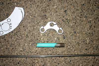

ok so here is the frame caps (freeze plugs i bought at work for like 30 cents a peice) that i will weld on the the ends of the frame to cap it they are dome shape as well so it will look cool too. They are galvanized so i will grind the edges clean before welding also theese plugs are 1 1/4 the same size of the tubing so for 60 cents it fits perfect and saves me time.
this is the frame gusset for the head tube
and working on the rear drop outs still gota fab the built in chain tensioner

this is an interesting build, I like it so far. did you cut the tube then put your drops in the slots or just cut the drops. I like to slot the tubes an put whatever in then weld. either way, looks good. you sure ya never did this before. ya do nice work. still watchin.

thanks muller and stretch. actually i cut two slots into the drop out instead of cuttin out the whole chunk out of the drop out and slid the tube over that made it really strong that way and could of rode it wit out the drop outs bein welded.kinda had to press them on lol really tight fit.oh and this is my first frame build ive made alot of stuff but not a frame so i said why not,so this will be the first to many im alredy thinkin of the next one for my wife.Thanks for lookin

really nice. thats even a better idea how ya did the dropouts. will have to try that one. thanks.
