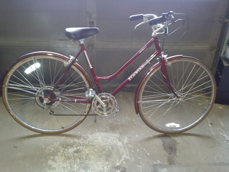

So, I have a Schwinn World Tourist that I got for free.
It's a pretty nice bike, but my wife doesn't want another bike...what to do??
Strip it down and make a sweet men's bike out of it!

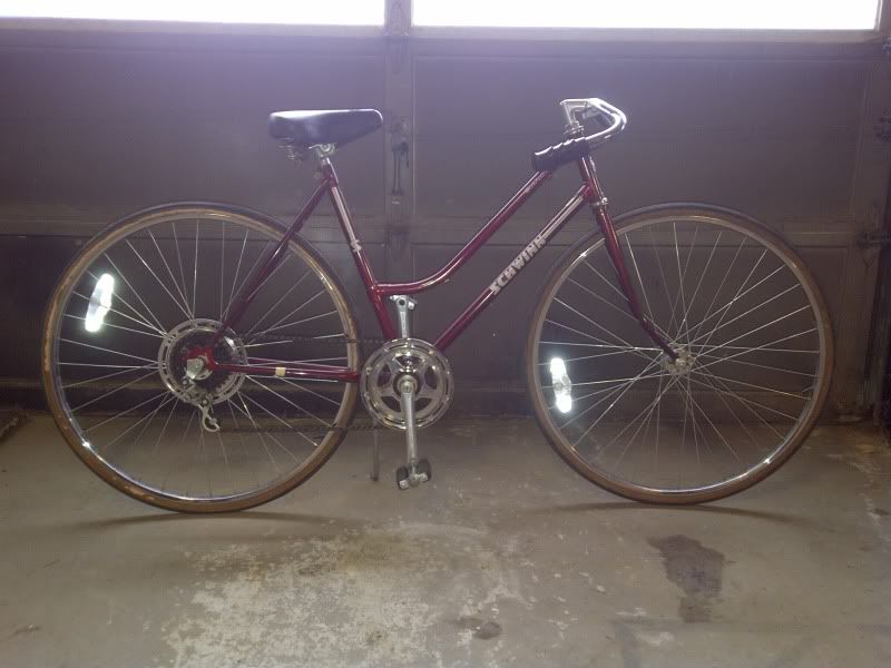

First step, strip it down.
Done, I flipped the handlebars for more of a boardtrack look. I'm more of a single-speed/coaster brake kind of guy. So, bye-bye shifter and hand brakes! I want to put some fatter whitewalls on it, but it's a skinny tire bike, plus I need a coaster brake, new wheels ordered. BUT, the front forks, rear chainstay and seat stay are too narrow. I have a vintage fork ordered and I'll have to re-work the rear end.

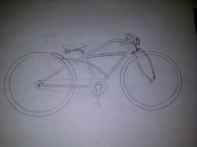

Here's a rough drawing of what I'm going to do:
I'm going to cut the top tube off and reverse it, stretch the chainstay about 7", build a new seat stay. Cut down the seat tube, bend the seat post, add some additional tubes (for looks), truss rods, and a headlight.

if it turns out anything like the drawing it should look pretty sweet

And here's the drawing comparison for the progress so far...
There's still more to do, but we're off and running now!
