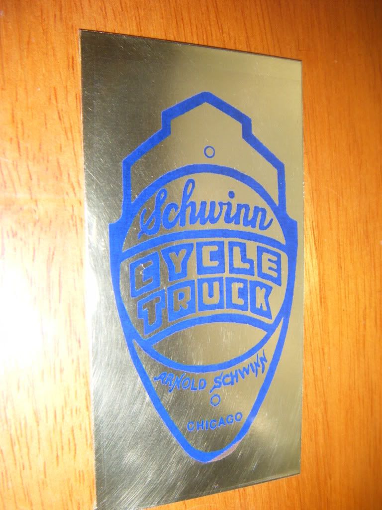

I prepared my artwork with some old graphics software and made sure that I could print the artwork to the exact size of the finished headbadge. PhotoShop would be great or another good free one is Gimp http://www.gimp.org/
I cut my brass sheet to slightly larger than needed.
I de-burred the brass around the edges.
I roughed up the brass with steel wool and then cleaned it with dish soap and water to remove any oils.

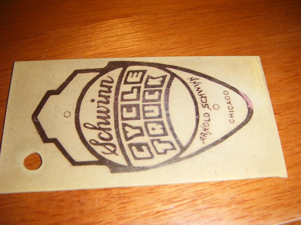

I transferred my artwork to the brass using the instructions here: http://www.techniks.com/how_to.htm
I let the brass sheet cool for 10 minutes before peeling the blue transfer sheet off.
I drilled a hole in the corner where there would be no artwork.
I spray painted the back side of the brass to prevent etching on that side and then let it dry.
I secured the zip tie through the hole in the brass so that I could pull it out of the etching solution without reaching into the solution.

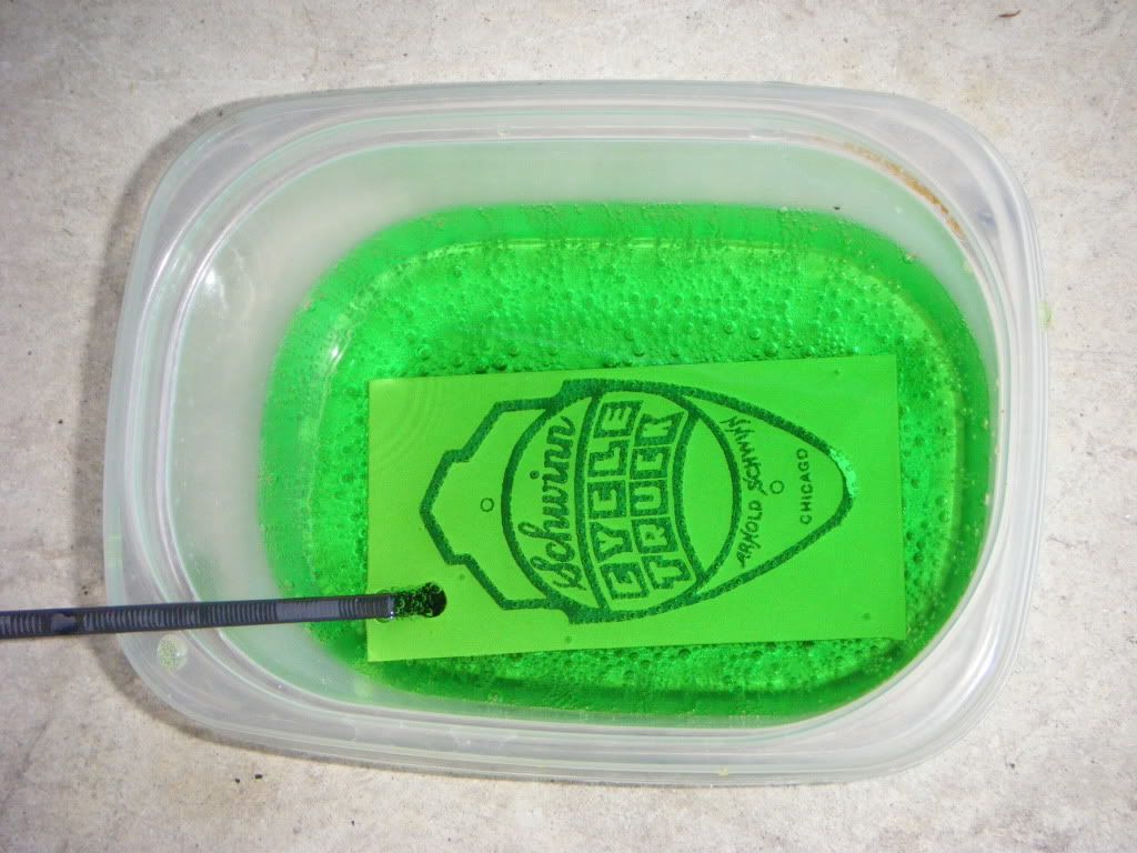

I mixed my etching solution; 1 cup of hydrogen peroxide into the plastic container FIRST! and then GENTLY/SLOWLY! added 1/2 cup of muriadic acid to the plastic container.
HAD I ADDED THE HYDROGEN PEROXIDE TO THE ACID, I COULD HAVE BEEN SERIOUSLY INJURED!
I filled the 2nd plastic container with plain water.
I GENTLY! lowered the brass into the etching solution with the artwork face up.
After roughly 20 minutes, I removed the brass from the etching solution and rinsed it in the other plastic container with water.
I removed the blue film and paint from the brass with brake cleaner.

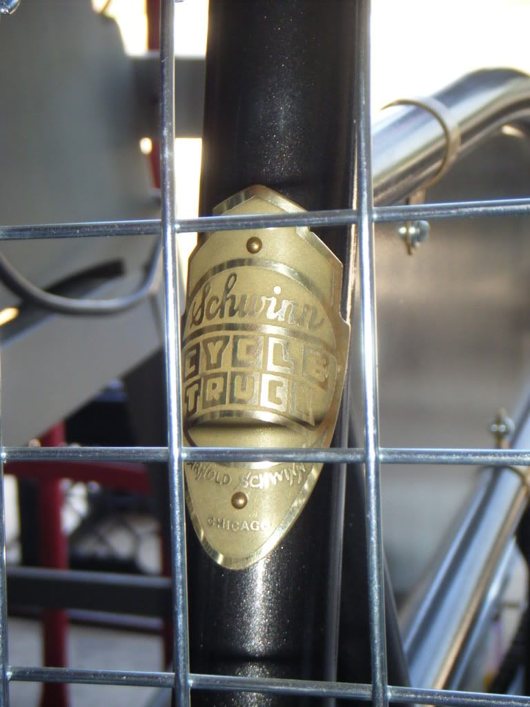

I'm impressed! Very nice work. Better living through chemistry. 8) I have peroxide and muriatic acid but they are both clear. Why is your solution green? How are those brass nails held into the frame? Gary

Postby CycleTruck on Sun Sep 11, 2011 7:29 am
You're welcome all.
The solution turns green as it eats the brass away.
Those are actually brass rivets that I had laying around and they're a pretty tight fit.

How did you make the nice smooth curve to fit the frame without putting creases in the badge? This is one of the best "how to" threads I've seen for a while. I'm going to have to try it. Gary

Postby CycleTruck on Mon Sep 12, 2011 7:47 am
B607 wrote:How did you make the nice smooth curve to fit the frame without putting creases in the badge? This is one of the best "how to" threads I've seen for a while. I'm going to have to try it. Gary
Great question. I should have included that at the end. I started the curve on the badge by hand forming it around a pipe that's slightly less than the diameter of the head tube. To finish it off, I used a nylon ratchet strap as a strap wrench around the badge and gently formed it until it fit the head tube.

that is a great idea, i have a a couple q's, i didnt see this, how did you get the image cut onto the blue transfer. and am i correct when you said you left the transfer on the brass while in the solution. than washed it off when done. i wonder if vinyl would work the same way.
linksandkinks
Posts: 26
Joined: Mon Apr 26, 2010 12:43 pm
Location: fairborn, oh
Re: Making My Own Head Badges
Postby ozzmonaut on Mon Sep 12, 2011 10:25 pm
linksandkinks wrote:that is a great idea, i have a a couple q's, i didnt see this, how did you get the image cut onto the blue transfer. and am i correct when you said you left the transfer on the brass while in the solution. than washed it off when done. i wonder if vinyl would work the same way.
I believe he first removes the backing paper of the transfer sheet, which will leave a film that separates from the backing paper when heated with an iron. This film is what stays on during the etching process and is removed later.

Postby CycleTruck on Tue Sep 13, 2011 12:07 am
I print my artwork on the transfer film in a mirror image, then iron the film to the brass. The laser jet toner melts and makes the film stick to the brass. An inkjet printer can be used with normal paper then a copier to copy the artwork onto the transfer film. I let the brass cool before peeling off the film and what's left is a blue film image of the artwork. If there are bare spots that didn't stick to the brass, I color in the bare spots with a Sharpie or even hobby paint. The etching solution will remove brass from where there is no artwork.
The official instructions are here: http://www.techniks.com/how_to.htm
