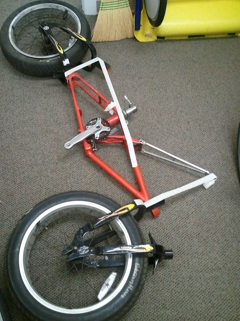

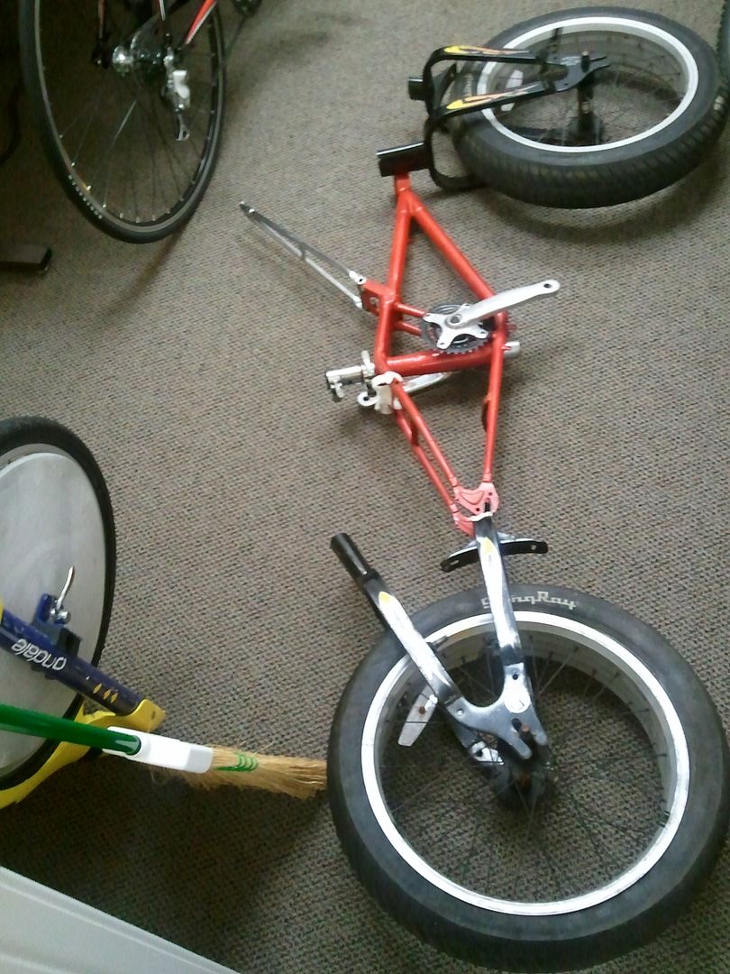

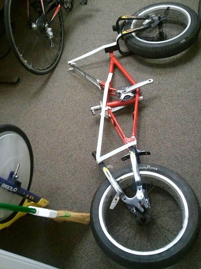

Brought the frame parts into work to show my co-worker that will be doing the welding for me. We laid it out on the floor and I used some masking tape to show where we wanted to weld supports.We should be able to start welding this weekend.
