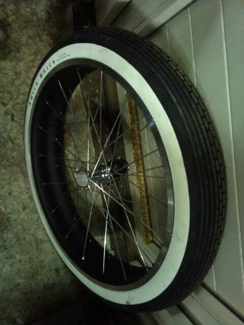

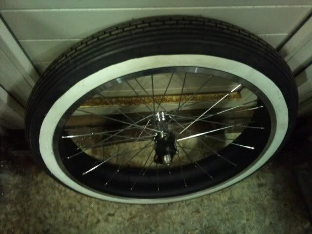

Okay, my XL frame is being blasted and primered, so i started a new project. I was going to keep it to myself for a while, but it is so cool, it feels just plain wrong to not share this...
So here's the start:
It ll have a low stretch-ish frame and another 100mm rim in the with a normal 3sp hub.

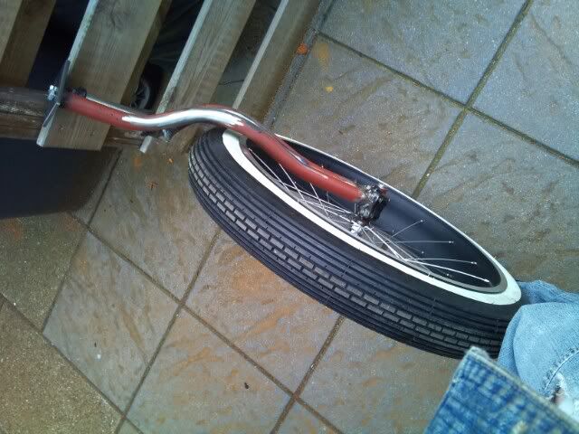

What do you guys think about the fork?

Postby X-RAY on Sat Mar 12, 2011 12:37 pm
pretty wild, man! i like it. 8) how did you do the one sided axle?

Postby Hoeha on Sat Mar 12, 2011 3:44 pm
thanks guys! i found a secondhand single sided hub, which i laced in the rim. i used 12mm shorter spokes on the axle side to get the fork attachment "inside" the rim.
Glad you like it :-)

Postby nick_ish on Sat Mar 12, 2011 4:17 pm
Sounds good to me how did you make the fork by the way?

Postby Hoeha on Sun Mar 13, 2011 4:37 am
Well, i bent some tubes, welded themto a clamp for the axle, and a headtube on the other end :-)

Postby Hoeha on Sun Mar 13, 2011 8:03 am
You can get a hydraulic tube bender for only 100 euro's. Or just torch the heck out of the tube and then you just bend it by hand. it ll stay nice and round to.
Learning how to weld is really easy. Learning how to weld good takes a little longer. I still have a lot to learn...
