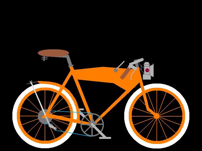

A Microsoft Paint rendition of what I'm sort of aiming for (there will be the classic tank graffic of course)

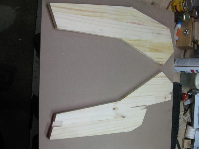

The first thing is to make a tank, to me one of the real focal points of the Flying Merkel. I made templates out of cardboard. BEcause of the the shifter on the top tube (I realize i could move it, but its most practical there) I will be using a cut-away on that side, with a plate to cover it later. Ill add another plate (made of a thin masonite-like material) to the other side to keep it even.
Tanks cut from wood. i have chisled out grooves for the brake and shifter cables.

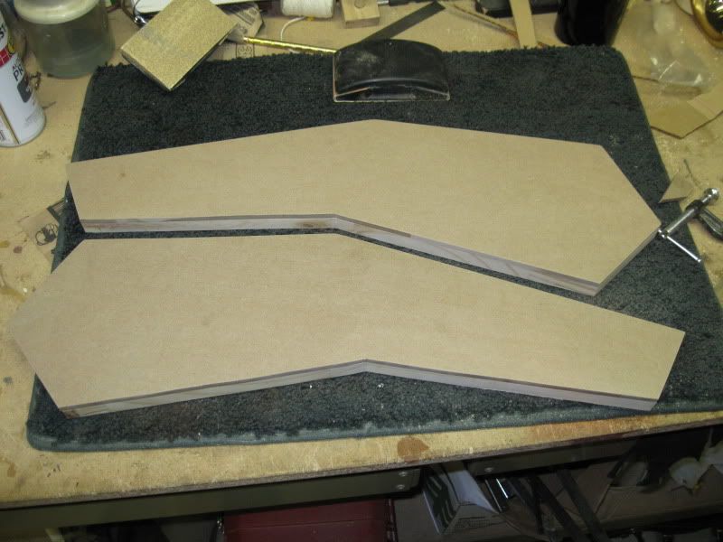

THe plate material, being traced, rough cut, and then sanded flush with the perimeter of the wooden forms.

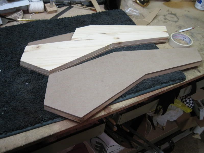

Got the tank boards set up to mount. I used 4 dowels (two above and two below the top bar) to brace the boards. After everything is painted, the fnal step will be to put these boards in place, glue and flush cut the dowels, and then glue the plates with the decals over the boards. I realize this is a little confusing to describe, hopefully the pics will better illustrate my method. In the end: the 'boards' are thick mountings that comprise the tank itself, one which has a cut-away for the shifter. The 'plates' are thinner planks that will have the 'Flying Merkel' script on them, and will be glued to the outside of the boards to conceal the dowels and holes, giving is a nice clean surface.
Here you can see the tank 'sandwich'
