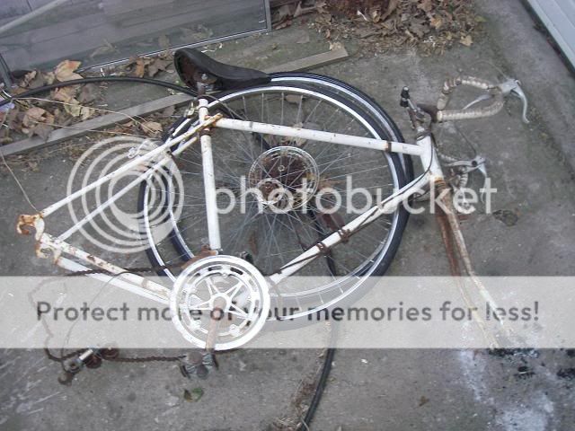

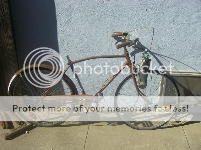

I saw this Armstrong leaning up against a tree in a driveway just outside Lagunitas California, just north of the bay... On my way back from the wedding I was attending near Point Reyes I stopped to ask about it. A little scary because of the Big fence and all the no parking signs. However the owners were more than surprised that I wanted it and gave me a columbia 10 speed as well. Said I saved them a trip to the dump... So with that good luck I decided to throw this bike together for the buildoff. Gives me something to work on while I'm in california away from all my other projects. Hope you all enjoy.

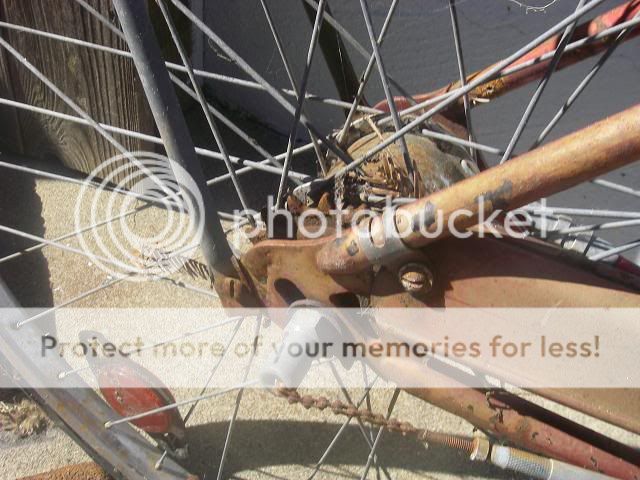

sturmey archer 3 speed rolls just fine but it needs a new shift chain before I can test the gears...

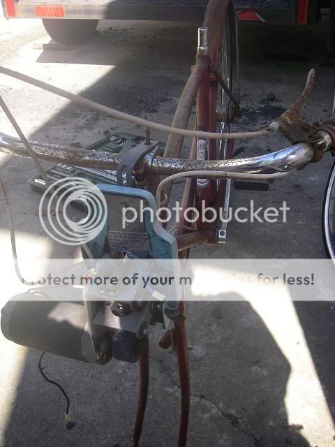

this is an electric bike conversion... motor drives the front wheel, speed controlled by the second brake lever. battery was probably in a basket.
I'll use this bike for some parts but I'm most excited about the head badge which I was missing from my tandem.

Breaking into the bike... I'm using lots of penetrating oil and plenty of brute force to get this bike apart. The cottered cranks are being a real pain... if anyone has any hits on these I'll gladly take your advise. I'm going to try adding a little heat at work tomorrow. This bike has sat in the open against a tree for something like 6 years in the wet north bay woods. the worn paint and rusty chrome have so much character that they are going to dictate the rest of the direction of this build. all work will be purely mechanical rebuilding the general looks of the bikes finish will not improve. Need to make and angled seat post and get one of my ancient brooks saddles sent from phoenix. rear fender will be bobbed and the rest used for a front fender. Maybe a tank from some weathered wood hung from the top bar. need to find some really rust accessories now!

I got to work putting the bike back together today. regreased the bearings in the bottom bracket, headset, and front wheel. headset had 48 loose bearings in it. went everywhere when I opened it up but I only lost one. I love having a hardware store just a minutes walk from the house makes replacement bearings so easy! Crank shaft looks like it may in fact be a raleigh. I think that's who made the armstrongs. If anyone has any more info on these bikes I'm not having great luck tracking any info down. Did a quick mockup in the kitchen just for pictures since it was dark outside. I'll take the rear wheel into work tomorrow to break down that 3 speed. then it's time for a trip to college cyclery for some parts.

Internet was down yesterday but I went shopping at College Cyclery. Got everything I needed in one stop! Threw the bike together so I could ride it around friday. No gears yet but it was still alot of fun! Still looking for an old beat up leather saddle and I'll be done.

Postby pvwacko on Sat Jul 24, 2010 8:46 pm
Finally got back to where this project was waiting in sacramento and found the perfect seat just in time! Not a brooks but it is nice and comfy even without any padding. She's all done now and ready for some rides around the bars. :)
