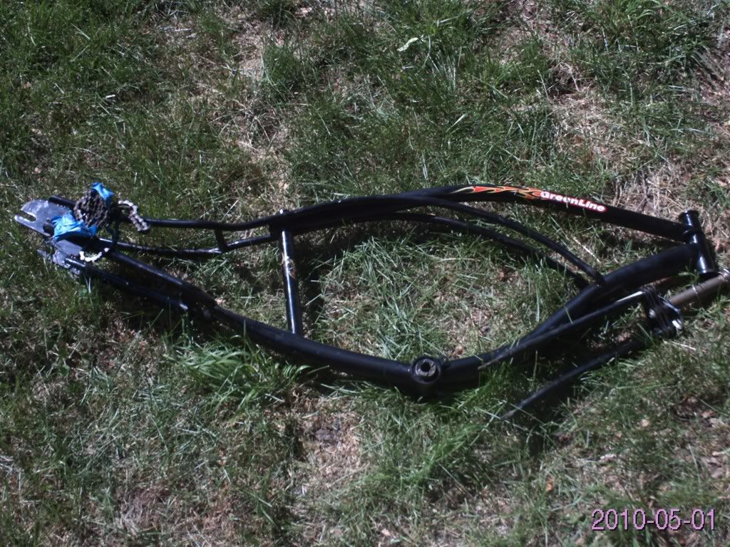

Whoo Hoo! RRBBO5 begins! My entry this year is this Greenline frame i've had floating around the shed for a couple of years now. I've got some great ideas for it that i hope everyone will like.

Okay, so the first thing to do was figure out the front suspension. The springer parts are from a Schwinn style 20" fork and I used another fork from a 70's Huffy girls bike because it had the longer head tube i needed. It seems to work very well, kind of like a reverse beehive. You can expect the rear to have a similar set up as well.

all ive got to say is i would buy a fork like that !!! are the truss rods beefy enough with that set up for big bumps ??

CCR wrote:all ive got to say is i would buy a fork like that !!! are the truss rods beefy enough with that set up for big bumps ??
killer start man, i like it :)
i agree, i have some truss rods like that and they bend really easily

when the spring action works it pulls on the truss rods, it doesn't push them up like a beehive does. i can't see how they might bend as long as it's pulling on them. i bounced the front end with all my weight and it seems to work great. i'm sorry the pictures are fuzzy, it makes it a little hard to see exactly how it works.

i can see what your saying, "pull" wont bend the rods but "push" might, and it doesnt look like there would be any "push" involved in that setup. its like a columbia fork in a way. love how how you came up with using what you had around, i dont think my brain cells could have pulled it off successfully :!:
