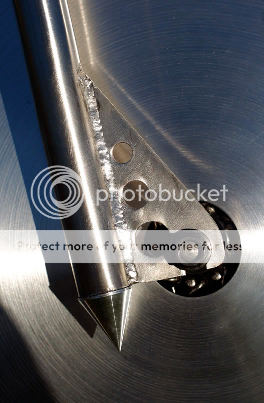

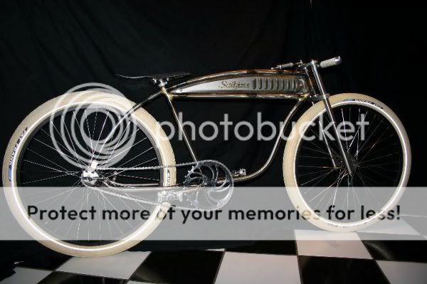

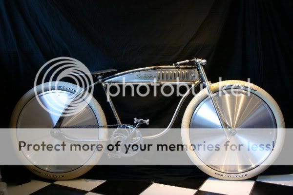

I finally got Saltfats finished up just in time, here are the specs.
Frame;
40s Hiawatha frame stretched 3"
Unnecessary brackets were shaved and left in raw finish
Clear powdercoated frame to show weld heat burns and original brazing
Custom side panels in raw coated finish with louveres and gold leaf scripting
Forks;
Custom made sealed bearing headset
Fork tubes ground medical grade stainless
Lower tripple slightly modified Giannini R-2
Upper Tree from scratch to get the rake right
Fork tubes got custom aluminum pointed caps top and bottom
GRC 26 way adj. steering damper
Bars;
Custom built stainless clip on style
Custom aluminum bar end caps
Heat wrap exhaust tape double layered.
Seat;
From scratch Hardened Aluminum Pan pressed and then contoured with an english wheel and mirror polished top and bottom.
Stainless steel solid seat post and mounting bracket.
Cranks;
Stock Hiawatha cranks were stripped of chrome heated for torch marks and powdercoated to match frame.
Sprocket is original skip tooth
Custom rear sprocket
Modern bmx pedals with cut down cages and brass hardware.
Wheels;
Bicycle exchange supplied double walled heavy spoke 26"
Mooneyes wheel covers.
Schwalbe Creme Fat Frank Tires
