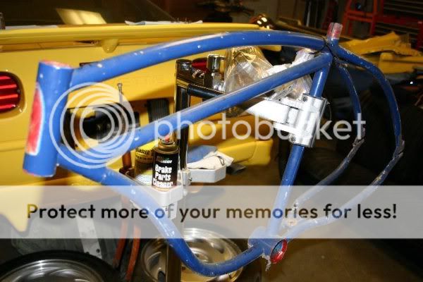

Ok, I am late starting the build but am pretty sure I can pull it off before the deadline. I am doing a Saltflat themed bike starting with a 40s Hiawatha frame only. Today the frame is being stripped and lengthened by 3" and the forks mocked up.

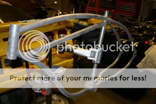

Decided where to cut and lengthen the frame so chopped it and made these sleeves to weld into place. This will allow for a stronger weld joint and make metal finishing easier.

Waiting eagerly....love anything to do with the flats. Love your way of stretching a frame wish I had a lathe. I found that a good piece of angle iron works great also to hold your piece your adding to the frame.

jezusjonz wrote:Waiting eagerly....love anything to do with the flats. Love your way of stretching a frame wish I had a lathe. I found that a good piece of angle iron works great also to hold your piece your adding to the frame.
Terry
Thats exactly how I line things up while tack welding. I built up the forks and headset stuff today so will post photos later.

What would it cost to make a set (3)of those "stretching" inserts ? I have an old Marshall-Wells ZENITH that has a motor installed on it.....It would look good stretched ! Then I could fab up a long tank for it!

Get some 1/4 wall tubing with the correct outside diameter, in my case it was 1" and any local machine shop could turn down the ends for you, probably an hour shop time. Don't assume that the wall thickness is the same on all of the tubing on your bike, mine was built with two different tubing sizes.
