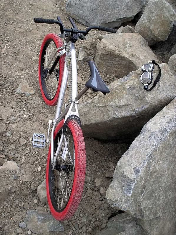

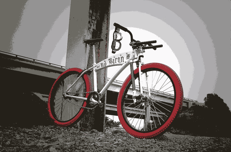

Achtung! It's done! My WWI-themed take on a modern-day Monark.
Lest we forget, it started out as the frame from an abandoned Diamondback Voyager, and a Control Tech Leader fork with an obscenely short headtube that I grabbed for $70 from a bicycle co-op:
Trimmed the frame's headtube, seat tube and a bunch of cable fittings, cleaned up the frame and added new engine-turned tank panels. Wheels are DH-39's with freebie red cruiser tires.
Bars are Haro Slim Bars with the bottom chopped off. Pocketbike clip-on brackets hold 1" seatposts for use as machinegun/pursuit handlebars.
More pics:

The focus of this build was really to make it a solid rider. With that Leader fork and the 44/20T gearing, I can go for miles. I think the titanium seatpost I built might be a little stiff though - looking for something that transfers a little less vibration.
