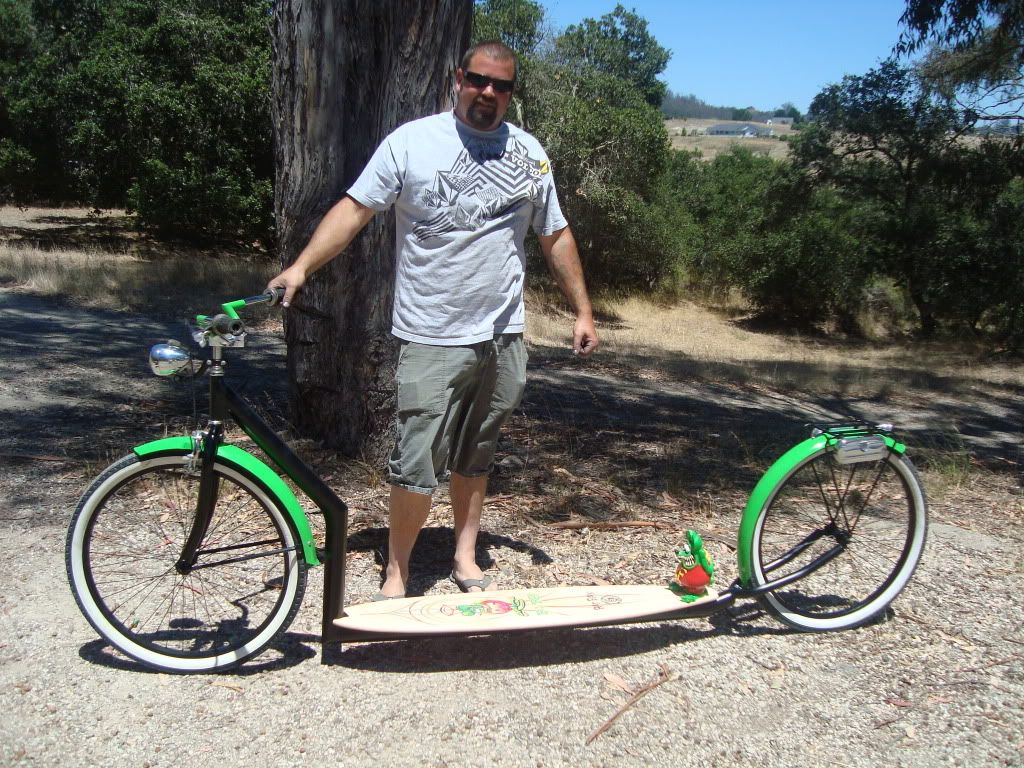

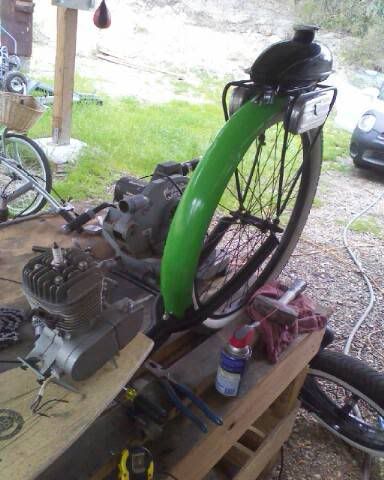

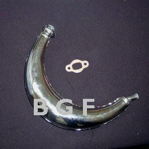

I built ths Scooter a while back Big Daddy Rat Fink tribute and now it gettin motorized! I picked up this 80cc engine on CL for cheap and im in the process of converting the scooter.This is gonna be fun!So far im porting and polishing the intake and exhaust,got a 48 tooth rear sprocket for the hills aeround here,and a expansion chamber exhaust! 8) :mrgreen: ImageImageImageImageImageImage

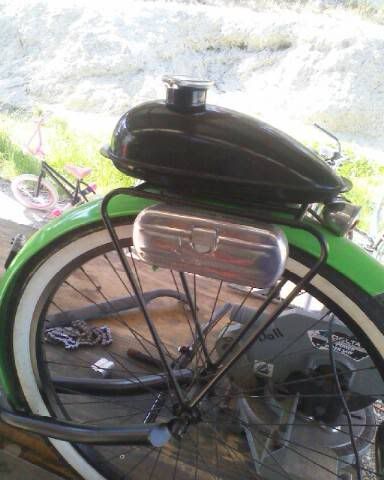

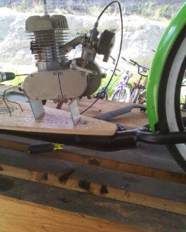

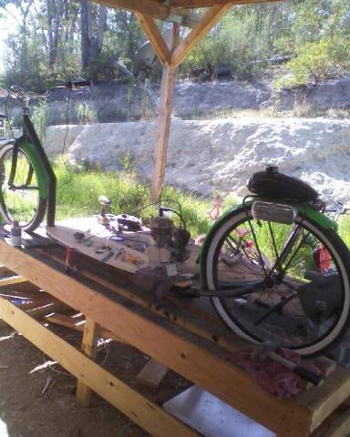

I got some work done today! I trimmed down the tank,cut and moved the petcock from the rear to the front,and patched the hole where cut it out. I think it looks a lot better this way. I put the sprocket on the wheel and im changing the motor mounts so it all jives together.The pipe came in and Im going to cut and reweld the flange so I can clock it where I want it,They come ran close to the motor for crank clearence but I want to run it out side the deck so ill cut it and make it work. 8) :mrgreen: ImageImageImageImage

I welded up the motor mounts and I slotted the bottom plate so I can adjust the chain so I think im done for today! 8) :mrgreen: ImageImageImage

I made a exhaust manifold so I can clock the expansion chamber where I want it,I think it should work allright....ImageImage
