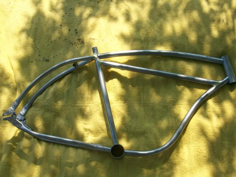

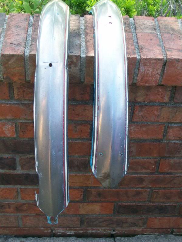

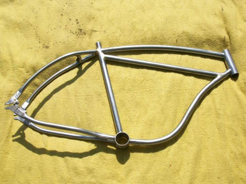

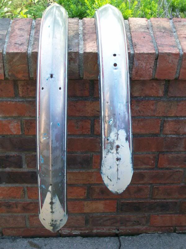

Yesterday's accomplishments - filed and sanded all the nooks & crannies I love complaining about, filled in 4 major dents (my first experience w/ Bondo) on the top tube & stays, and got the frame sanded down ready for primer - whew, I never thought I'd see this day. On the side I nailed the fenders with 2 coats of oven cleaner. Amazing - I went over these aggressively with a steel wire brush after the oven cleaner and the pin striping is like bullet proof. Nice thing about fenders - not as many "nooks & crannies". Slowly making progress - every other day I think I'm not going to have it done in time, but on the other days I feel positive that if I keep pushing forward I can do this. This is the longest project I've taken on in years, maybe decades. I think I can, I think I can ...

Looking good Robert. If your going to be stripping paint to bare metal try using Aircraft paint stripper. It's excellent stuff, removes multiple layers and when you done it rinses off with water. In the long run it will be cheaper than oven cleaner. I think this quart can was about 10 bucks and lasts awhile. Oven cleaner works great when your trying to save whats underneath....this stuff takes it all off :mrgreen:
It's available at automotive parts stores that sell paint supplies.....normally "NOT" places like O'Rileys, Autozone...etc!
Pickup up some cheap, cheap, cheap throw away small paint brushes to apply it, a small plastic scraper/cheap plastic spatula/putty knife to remove it, and some steel wool for the final clean. It will take off any paint, decal, bondo, etc......
It goes on heavy in one coat brushing in one direction.....resist the urge to spread it around once it's on. Let it do it's job and reapply for those stubborn places.
It's the best paint remover I've personally used......next to sand blasting :mrgreen:
Oh yea...use it outside because the fumes are really strong.

Yea, rico told me about the aircraft paint remover and he sent me some pics of it "in action". So these are the choices I had - one step aircraft paint remover for $10, no step sand blast for $25 or multiple steps plus mucho labor oven cleaner for $0 (I snagged 4 cans from my roommate who now has a self cleaning oven). There is no doubt in my mind that I picked the hardest and most time consuming choice but I'm unemployed, have the time and don't have any money. Hopefully next build I'll be working and can make a better choice. Thanks for info - I didn't know where I could get the aircraft paint remover or the price. Let me be the first to say that the method I am using sucks.

Postby Road Master on Mon Jul 12, 2010 10:08 am
Took the frame down by the airport fence and hung it from a tree on the hedge row to prime her up. Next up - Fenders!

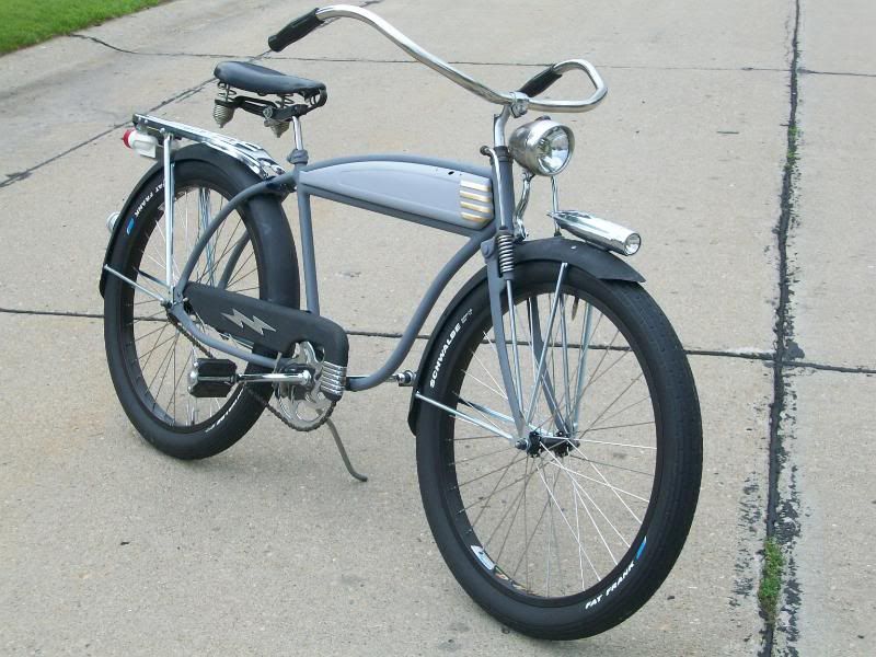

Postby Road Master on Tue Jul 20, 2010 1:29 pm

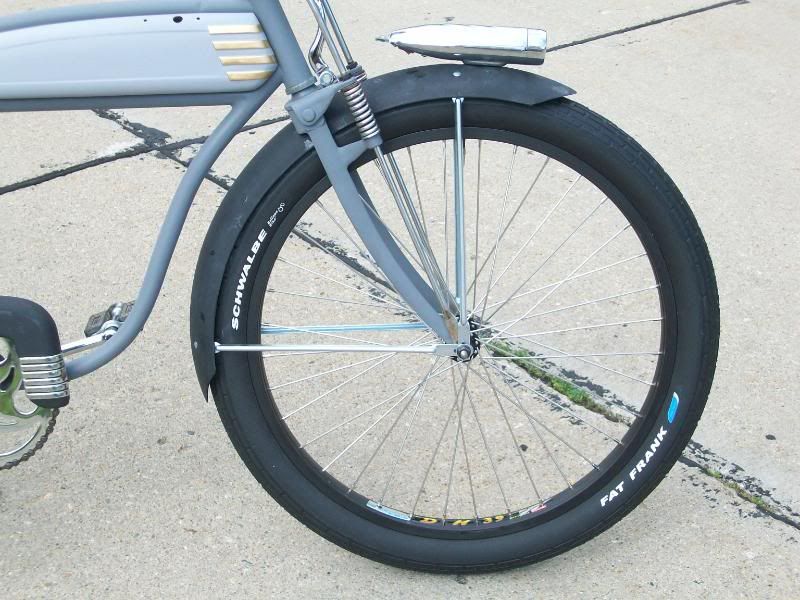

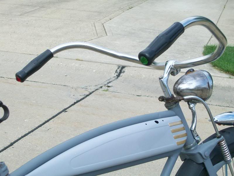

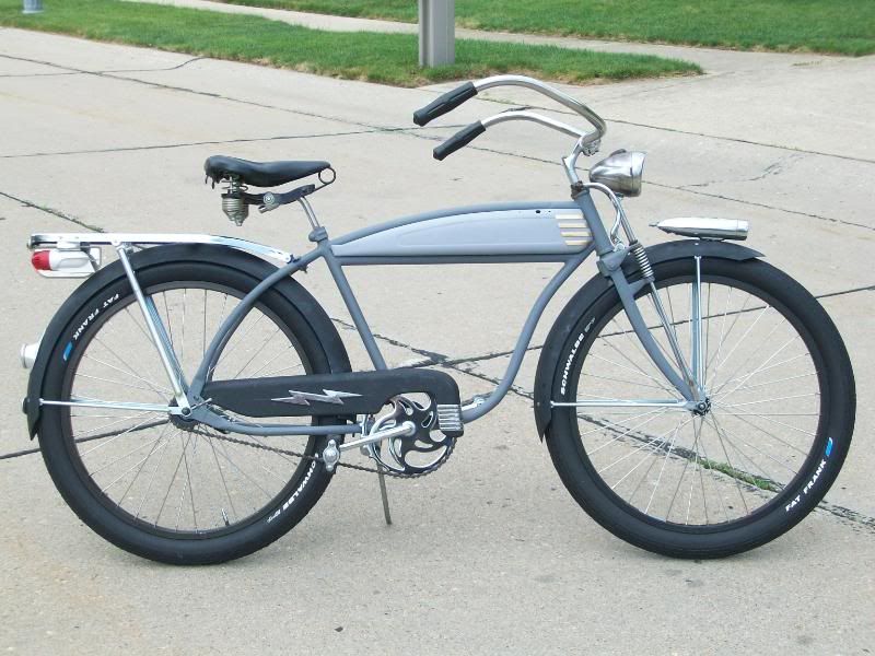

Reassembly

Re: CWC-1 Updated 7/20/10
Postby rico on Tue Jul 20, 2010 5:30 pm
Robert , job well done can't wait to see more :wink:
mike
rico
Posts: 1048
Location: San Juan,P.R.
Postby texasbigjon on Tue Jul 20, 2010 7:50 pm
man thats looking sweet! :mrgreen: that fork cleaned up really nice too! :D great job.
member # 1072.
texasbigjon
Posts: 1383
Location: houston,tex.
Postby Skipton on Wed Jul 21, 2010 1:10 am
Bike looks great!... The bars are very cool
Posts: 3541
Postby Leroy on Wed Jul 21, 2010 4:33 am
A good grey is always worthwhile.
Excellent job man.
Make sure you don't put the bars on the right way up.
Leroy
Posts: 122
Joined: Mon Jan 11, 2010 10:29 am
Postby Fastfix on Wed Jul 21, 2010 8:13 am
WOW!! :shock: :o :D
Mike
Fastfix
Posts: 55
Joined: Wed Apr 29, 2009 6:18 am
Location: Canton, OH

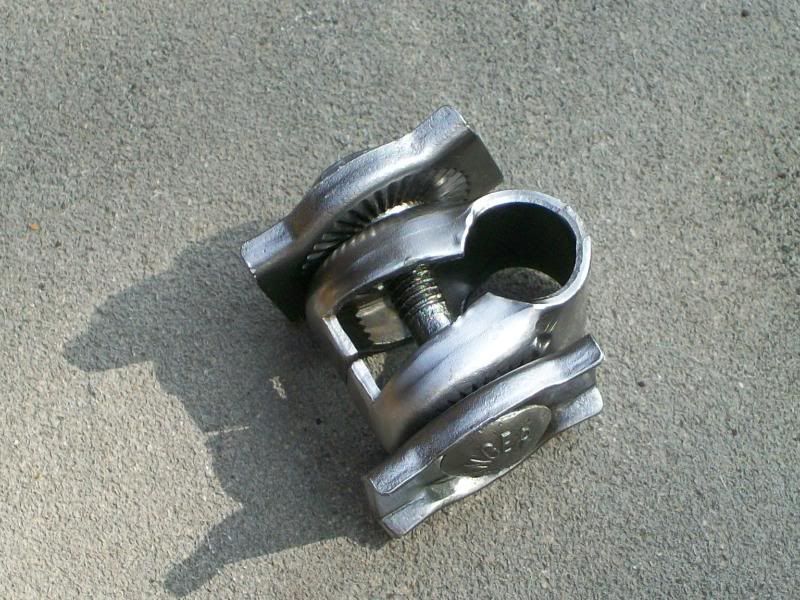

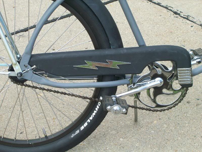

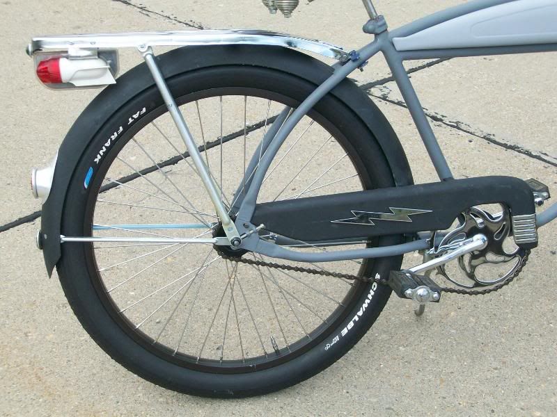

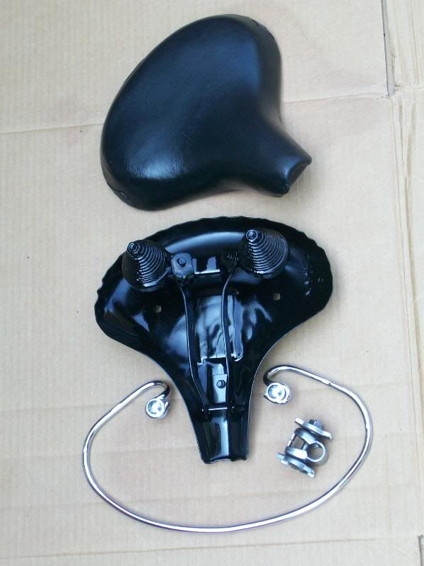

You know that dull funky finish they put on fender braces, seat clamps & what not - not a fan. I grind, sand, wire brush, anything I can to get that off of there. Then a clear coat and I'm a happy guy. You tell me, which do you like better?
If there's one thing I can't stand is rust. Some guys take a wire brush attachment on a drill and grind it out. To me that does about the same thing as triple chroming a part - no detail, no sharp lines - just everything nice and smooth. I was reading here recently in a "How To" section to remove rust electrolytically and the rust is replaced with iron. Now I've never tried this myself but on paper this scores a "10"! I use white vinegar to eat the rust off, buff it out with a Dremel (or drill) and a wire brush attachment till it shines. The more RPM and the lighter the touch the more she shines. Add a clear coat and again - I'm happy.
So I go into Lowes the other day and just inside the door in bins are small hand tools for $1.95. I snagged two of these little gems - I can't tell you how many times I've had to improvise a larger tool to do what theses babies were born to do.

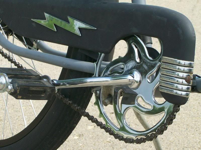

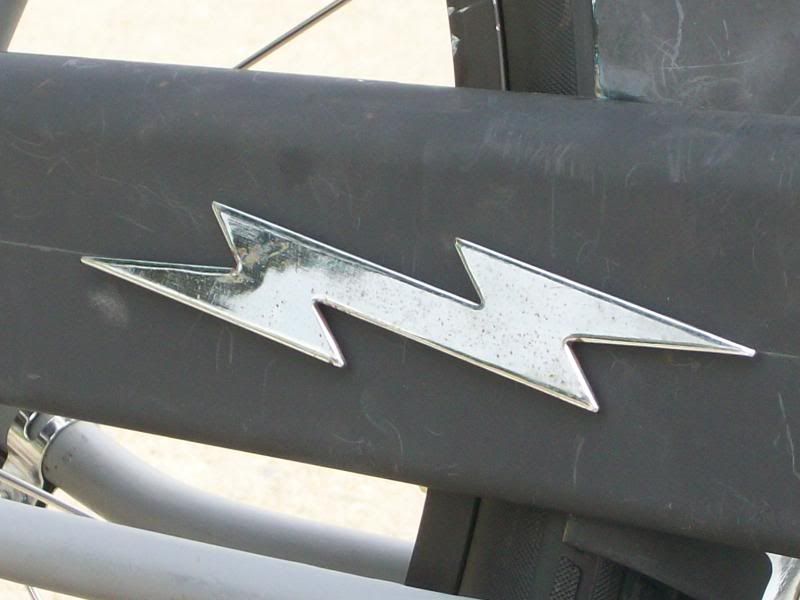

Learning Curve Lesson Number 37 - after I removed all the paint from the chain guard I noticed a lot a good chrome left so I'm thinking two tone - chrome and black. When I held the part up where light would reflect off it I could see the edges curve around and then flatten out on the face kind off making a line. I took a Sharpie and put marks along the reflective line. Now in my career as a carpenter everything we measured, cut and and installed was to the center of the mark. So I mask it off, prime it, paint it black (did somebody just hear The Stones?), remove the masking and I see what appears to be bleed through. I'm thinking that blue masking tape ain't all it's cracked up to be. I put my 4 power glasses on and you know I'm looking at - the other half of the marks - DUH. If you zoom in on the pic you can see them plain as day.

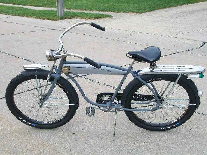

A little after midnight I finally got the chainguard and pedals on and took it out for my first spin since I disassembled it. Just last week they finished repaving our whole complex with new black top. We have no exits other than the main entrance so every street ends with a cul de sac making it a non stop run through from one point all the way around and back to the original starting point. The only thing I heard was the chain eating through the sprockets and the whine of the Fat Franks maxed out at 65 lbs after I got up to speed. Magnifique!
