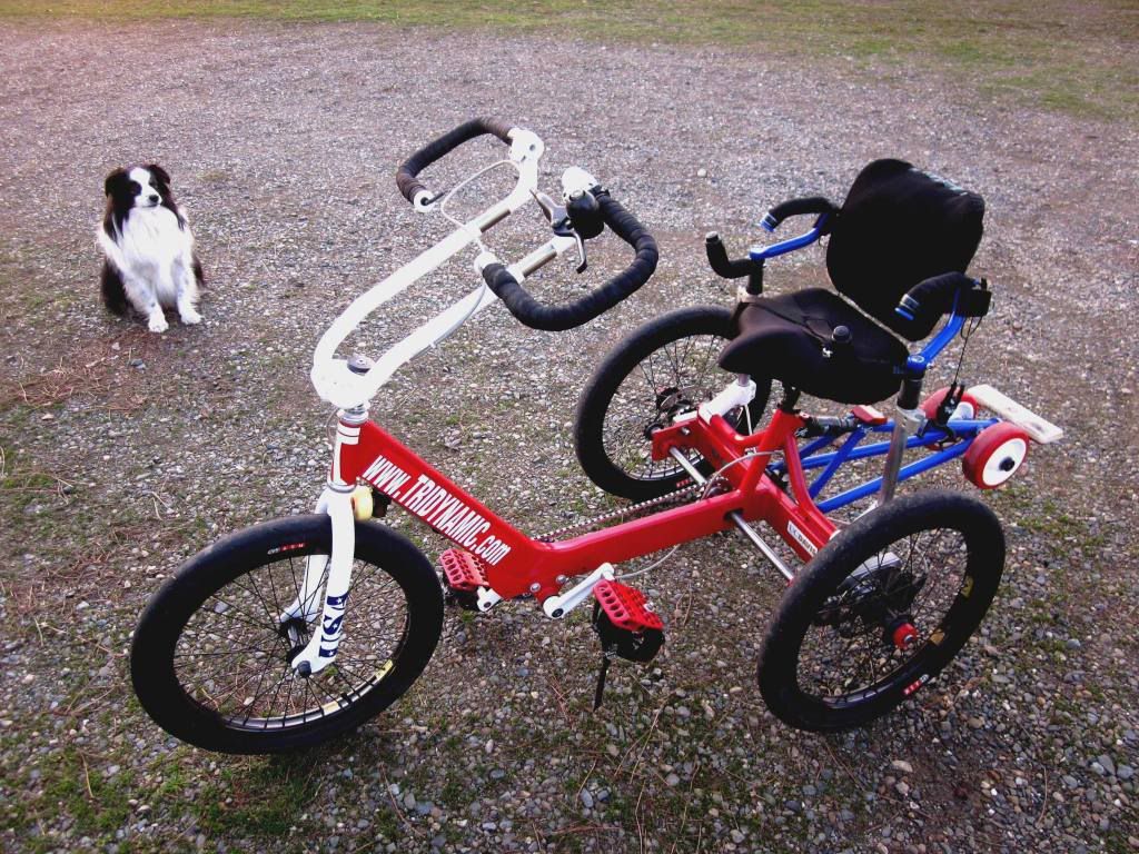

Very cool. I instruct adaptive skiing at our local ski hill. Providing those opportunities for all is great and equipment should never be an issue.
Just watched the video....is that fixed gear as your son pedaled backwards?
Posts: 9701
Re: build(U.S.Patent) 7,819,414
Postby Tridynamic on Tue Jan 31, 2012 4:36 pm
Thank's
I know but it is always a serious( responsibility ) issue when technology becomes so outdated.
No it is not a fixed gear. A fixed gear can present many problems including ending the cycle / the device tipping over in a turn or spin etc. many outdated adapted for independent therapeutics- tricycles do come fixed though.
I have developed an adjustable clutch which works in several ways( fixable gear ).Can be fixed but works great adjusted somewhere in between. So it acts as a 1. freewheel or 2.freewheel /coaster brake- that wont lock up / 3.and or fixed, which we have not needed to employ.
Tridynamic also comes standard with a type of posi traction / two wheel drive. Just add a chain to the other ...( jack axle to driven sprocket/ wheel ).. side when sprinting 100- 400 meters on a track maybe in special Olympics or other
any other questions I will be happy to answer and you can visit the website http://www.tridynamic.com
Take care

My friend's brother has CP and uses a Haas trailer trike for therapy. Does your clutch work similar to that style (variable pressure via a clamp against the cassette)?
Sent from my ADR6425LVW using Tapatalk
Posts: 9701
Postby Tridynamic on Tue Jan 31, 2012 7:21 pm
I am not familiar with Trailer trike ? Haas only that all "therapy" trikes for independent operation - outside of FDA non measuring/assisted ( rear push bar ) intended cycle for children strapped in at the the feet and ankles will roll over if tuning abruptly at speed.
My clutch is a poly urethane Durometer 80 or so. poly urethane matched with the metal housings provides many benefits
( fine,noise free and performance )
So yes it does clamp to the side of the freewheel body.
Metal on metal or other tends to cause to many (ware) issues....as we quickly learned
However, Tridynamic/ Tridynamics Special Needs Adapted tricycle -Tip over/ Fall risk awareness, prevention, education, and Long term( spasticity reduction technologies ) rehabilitation is the ( New and useful process )novel part . :D

I'm kinda surprised if the idea is to build something that won't flip over , why you wouldn't build something with four wheels instead of three. It was the change made by every motorcycle company to make their Atv's safer.
Uncle Stretch
Posts: 5813
Location: Pearland,Texas
Postby Tridynamic on Mon Feb 06, 2012 8:57 am
Hi,Then we wouldent have a Tridynamic would we :( Please understand that any vehicle can flip over, Utility Patents are granted for functionality and design as well as new and useful utility process/ introducing : Tridyniamic Long term rehabilitation for children . Four wheels will present way too many unwanted issues here,much less cost effective, awkward, and already exist without Tridynamic( TBI, Spasticity reduction - rehabilitation ) benefits.
I'm Surprised as well, That Men couldn't do something so simple for their children 100 years ago.( heck we cant even recognize it now when it's tipped over right on top of our kids ) Can you Imagine how many senseless TBI traumatic brain injuries, unreported, related- deaths-yes it happens: Regarding cute little tricycles.( Three wheeler's ) .....You Can Lead A Horse To Water, But Should It Really Be Drinking This Stuff? :o
