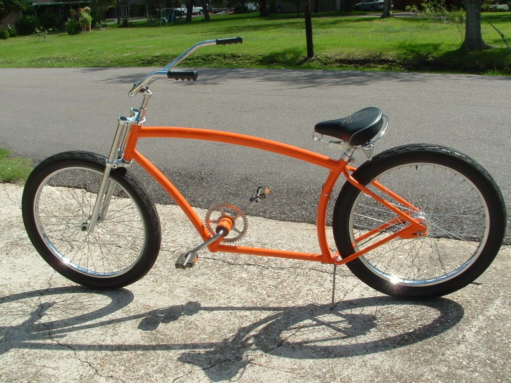

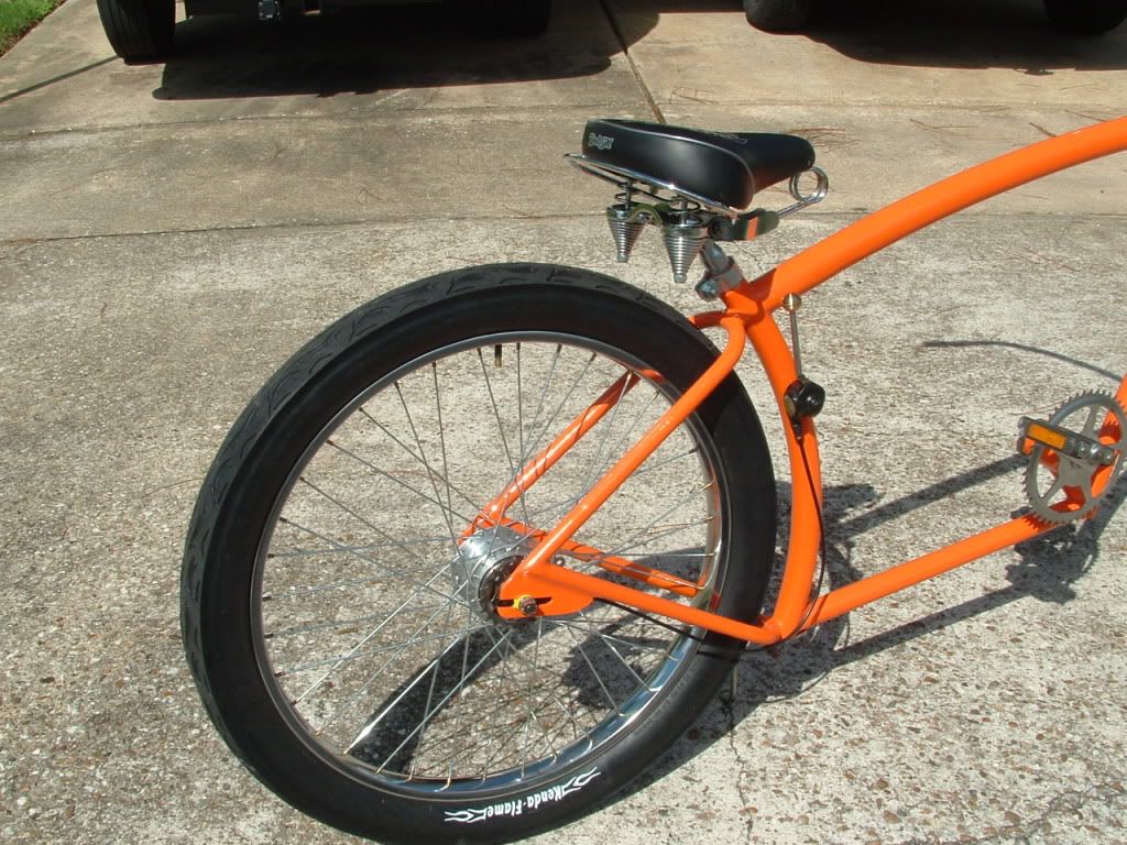

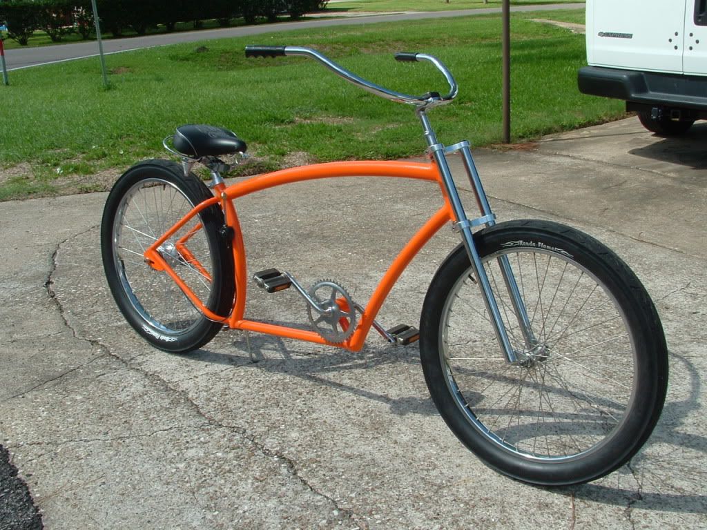

Ok I'm finished. It turned out better than I expected. It rides really good. The shifter arm needs to be about 2 inches longer ,but I'm callling it done.I took my riding pictures in 1st and should have been in a little higher gear,But I was distracted being a movie star. I'm glad the response has been positive towards my build. It makes me try harder on the next one. Maybe something a little more wildly designed. This one is pretty straight forward and simple. I was really just trying out my new bender ,and building bikes out of tubing instead of the schedule 40 pipe I normally use. This is a test for me and I'm happy with the results so far.
added a light,and the chain. :shock:
And for the proof it will ride

nice work Uncle Stretch ,the frame design looks great ,color awsome love that orange , fork looks good ,i hope you like using tubing now on your builds,i used 1 1/2 .095 wall and the same bender ,cant wait to see whats coming up next . Oh by the way what color orange is that?

I bought some 1 5/8 '' that was 11 gauge. That bender deformes it because the rollers are 1 1/2'' . it made a really cool oval shaped tube and that is what the top tube wound up being. A little harder to bend but really cool when your through. The two side tubes ...front and back are 16 ga.1 1/2 ,and the bottom one was 16ga ...1 1/8 '' so I was trying all kinda of sizes. This whole build was just a practice run. Now I know what I like and what my bender will do to what size tubing. I love that 11 ga. its heavy and welds like a dream. You can really burn it in without any problems. Then I just layed it out on my jig table and decided on a design. It was a simple not too radical of a design. I will take more chances on this next one now that I know where I'm going. The orange is by sparvar. they only have one shade. I found out real quick...if you want bright orange then spray it over white primer....if you want a more burnt orange then spray it over black primer. I went for the bright with white primer. Glad yall like it.

that frame was screamin`for a triple tree fork,to balance it out! :D the orange,black and chrome looks great together!great to hear the frame jig is coming out of retirement. :D :D
