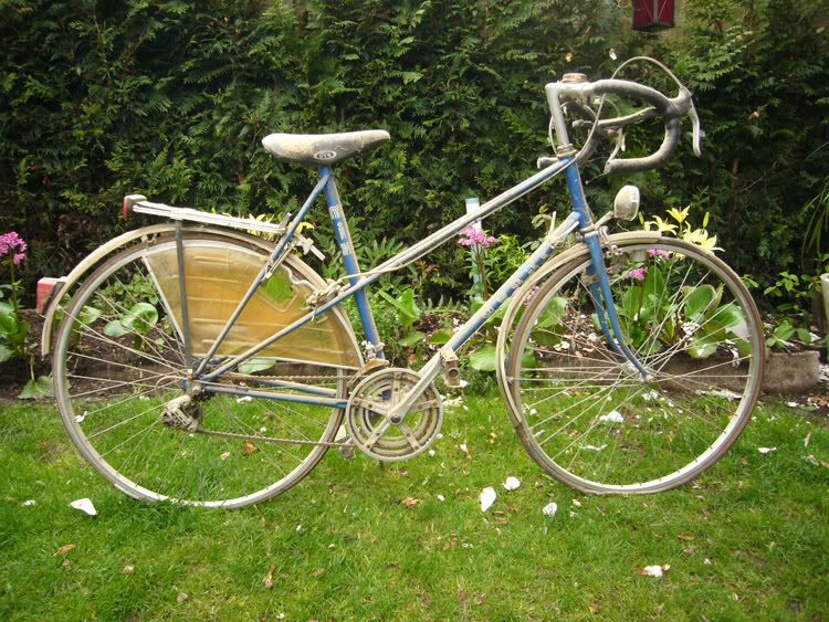

Hey everybody!

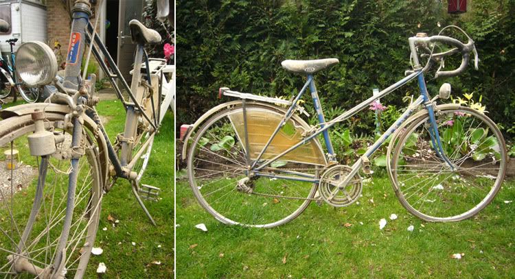

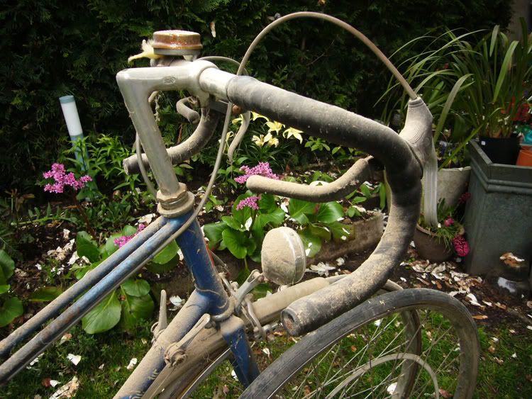

I've decided to bite the bullit and participate in this Build off. I was planning to resurrect this bike in the near future, so why not enter it in the build-off and start right away. Lately my parents' shed had turned into a real dump with stuff everywhere. Real messy with mice-droppings and sawdust in every little crack and hole. I knew there had to be some bikes in there below a pile of cartboard, foampanels, and what not, so I started diggin'...
This is what I found:

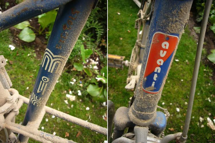

Right there all the way in the back (ofcourse...) I saw a strange looking blue frame with probably some decent hardware...
I can't remember ever having seen such frame. That is, not before I discovered this forum. I now know this frametype is called 'Mixte' but don't know where that name came from. (anyone?) However it does read 'MIX' on the seattube. And the 'headbadge' is just a cheap sticker withe the name 'AVANTI' . Maybe I'll do some research. The bike is fitted with the usual decent shimano parts and some japanese stuff. I'm planning to keep most of the parts that are really essential on the bike (rear brake for instance) rather than trying to search for better parts. Alot of it is aluminium an I like it, so I guess the few parts I'll be making will be aluminium as well. Hence the name of this thread. I have some experience making aluminium fenders which came out pretty succesfull, so I'l try and make it work on this Mix.

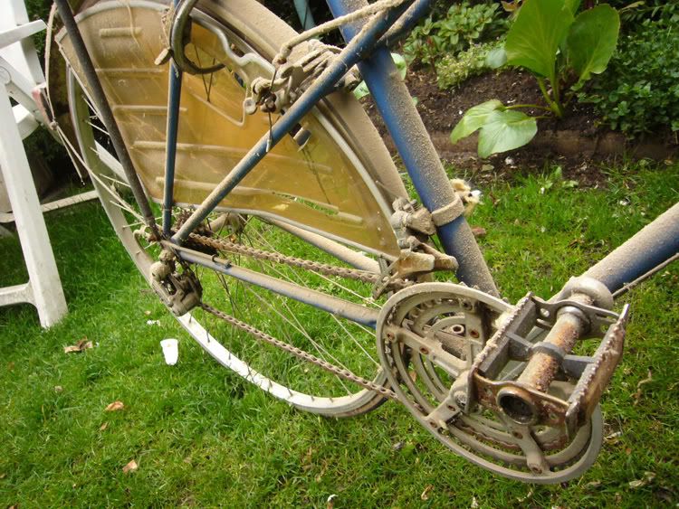

In the meantime I was able to do a first clean-up, and the bike came out nice. Ofcourse a lot of parts are rusted but I'll try to do some magic with a wirebrush and some steel wool. I was hoping to keep the original paint but it's damaged too much, and has baremetal rustspots everywhere.
And I hate rust... ;-)
Good luck everyone, and have fun!
(..oh, and I hope me using the 'b-word' in the title won't disquallify me instantly... ;-)

Postby herr_rudolf on Sun May 03, 2009 5:14 pm
Like I said: I cleaned up my soon-to-be Billet Bullit and it came out pretty okay. The first thing I did was fitting a fatter tire in the back and hoping for a quick build. That did not happen... The racey 28inch frame is not wide enough to house a smaller 26inch wheel with a fat tire like this Schwalbe Returner:
As you can see, the whitewall is rubbing the fork... Therefor the Schwalbe is going back to the ATB and I have to search for some other rubber candidates for the BB. After stripping the bike and removing all of the parts I REALLY did not want on the bike it looked like this:
And I must say, the racey-look of this bike is really starting to grow on me. I love the 1 inch wide backtire but will install it in the front. I'm going use a regular 28 inch tire from an ordinary bike in the back. I'm hoping for a subtle hotrod big'n'little effect on the tires. I fitted the cheap alu pedals I bought new for my ATB. Did not use them after concluding the ATB had different size crancks... Ah well, they do fit the BB much better anyway :-)
Today I made some new fenders. Pics will follow soon...

Sunday's progression.
Riding a bike in the Netherlands means getting wet half of the time and I don't want to end up with the infamous biker-skunk-stripe allover my body anymore. I want to be able to use my bike whenever I want to. Rain or shine... So, plans for some fenders were a-brewin'. I made some in the past from plastic and from aluminium strips (right from the hardwarestore). I once saw a tv-show where a carpenter was using it to simulate a 1950's diner. The ribbed material reminded me of custom car enthousiasts' favorite 'Briz-bumpers'! Very ArtDeco when used right. I've put them on my cruiser and a few months ago on my ATB, and it looks mighty fine! (will post pics of them later)
For my Billet Bullit I couldn't find the right width. All ribbed strips were much too wide for the skinny wheels I'm running... So I bought some plain and smooth alluminium strips in different sizes to experiment:
^ The struts are easy to make. Bending around a heavy tube will do the trick. The only problem is getting them to fit just right.
The fender itself is a different story:
^ Bending a bit too enthousiastically will result in many kinks instead of a steady flow... The best way probably is to clamp and bend it around a slightly smaller wheel. I used my knee, and had to work out many kinks... And then comes the endless road of, measuring/eyeballing, testfitting, drilling, assamble, disassemble, letting air out of the tire, and pumping it up again, and again, and...
Till it fits right.
^ Then it's detailing-time. This is the first time I made an effort to make the struts look beautiful on purpose. Rounding of the sharp corners and such...
Current state of my bike:
The frontfender came out perfect! with a gap of not larger then 2-3mm. The backfender was much more dificult , being longer, and requiring an extra hole for mounting it to the frame. The gap is a bit larger but than-again, It has some room for a slightly bigger tire...
Next stop: Sanding, brushing, and polishing the damaged aluminium seatpost ^
