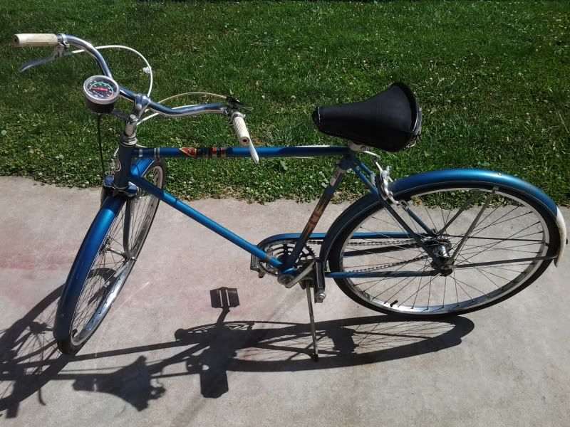

On this bike, no matter how much I tighten the seatpost (clincher?) bolt , the seat post still spins, slightly. By that, I mean it doesn't spin around like the wheel on WOF, but it will turn if I get all wiggly while riding. When I got it, the seat post was rusted in the seat tube and I had to struggle to get it out. I lubed it before putting it back in and now I have this problem.
A) Did I use too much lube?
B) Is the seatpost just a hair too small?
I don't know what to do. :(
Let me know if you need a better picture.
Thanks.

I'd get rid of the lube. Get some laquer thinner and wipe down the tube and run a rag with thinner down the hole. Do you have a chrome seat post? They are notorious for moving around no matter how tight you make it. Gary

Those seatposts can vary in dia. a fair bit, too. I think the size is more nominal than exact. I have some that I can swap around to get a better fit in a seatube and some that have been clamped so tight they are out of round, so some brass hammer tune up was required. See if you can find somebody with a few more to try out for fit, its hard to cinch one too small tight enough. Ideally you should have to work it in rather than drop in.

Any chance you're trying to use a 13/16" post on a 7/8" tube?

As soon as I get some calipers and am in the garage, I'll check. That was one of my thoughts as well. Thanks.

Sometimes you can slide sockets (as in socket set) in to get a good fit in a hole and measure that, just DONT drop one down in!!

Ok, so I finally measured my seatpost tonight. I may need to re-check it, as this is what I got:
Seatpost 20.65mm
Seattube 19.53mm/19.94mm
It was getting dark and I was getting tired. I'll check again tomorrow. But do these sound somewhat right?

Yeah bud, a millimeter one way or the other will make a difference. One of the mysteries of the bike world, why seven or eight different seat post diameters? Why not say, three? Two mm apart and you could get to be able to tell the difference by eye. But no. When you buy seatposts they come measured to the tenth of a mm. Good luck!! You'll find one, or find a shim.
