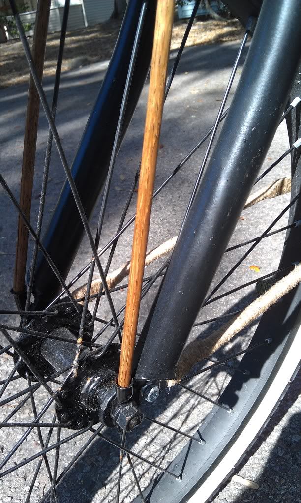

old schwinn bracket, 5/16 brake line, 5/16 wooden dowels that have been stained and shaved down, and 3/8 battery terminals. I had to copy the previous idea. looks so nice. :mrgreen:

I just got aluminum tubes and bent them with pipe benders to match a set of Schwinn truss rods I had. I also used an old Schwinn bracket to bolt it to the headtube.
After I bent them and cut them to shape, I smashed the ends and drilled a hole for the axle. Then I polished them to look like chrome. I should probably clear them but I'm too lazy.
