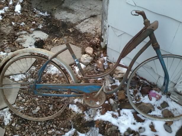

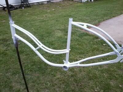

decided to start a post for the bike im building for my wife. Were calling it turtlelady after my wife nickname. It started out life as a western flyer sonic flyer
As I got the bike

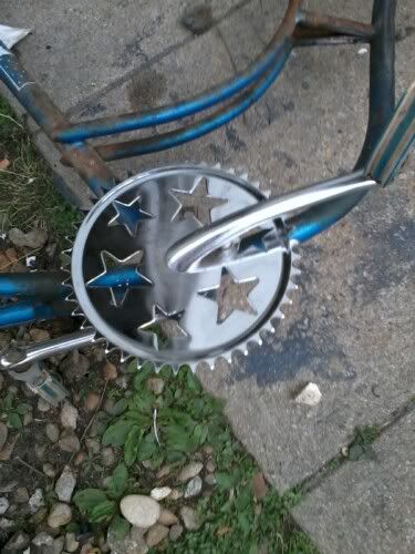

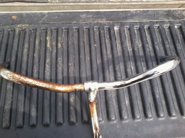

cleaned the chrome

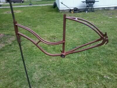

used rust converter primer first to get in the areas I couldnt when I stripped it
then coated it with a white primer
once its cured Ill sand it again then another coat of primer then ready for paint

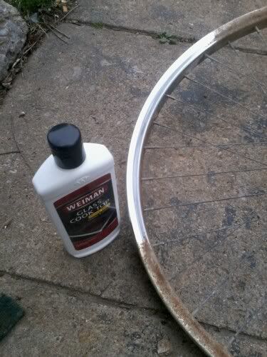

Great build!! What is that cleaner for the chrome and where did you get it?!? And that was buildoff caliber. Dude...Get ta Buildin'!! Peace

thanks jake, I cleaned it all with glasstop cleaner and a green scrubby pad. I would have been but Ive had it in the works for a while, have to get it done before I start my build off bike but did work on ideas for my build off bike between coats of paint on her bike.
