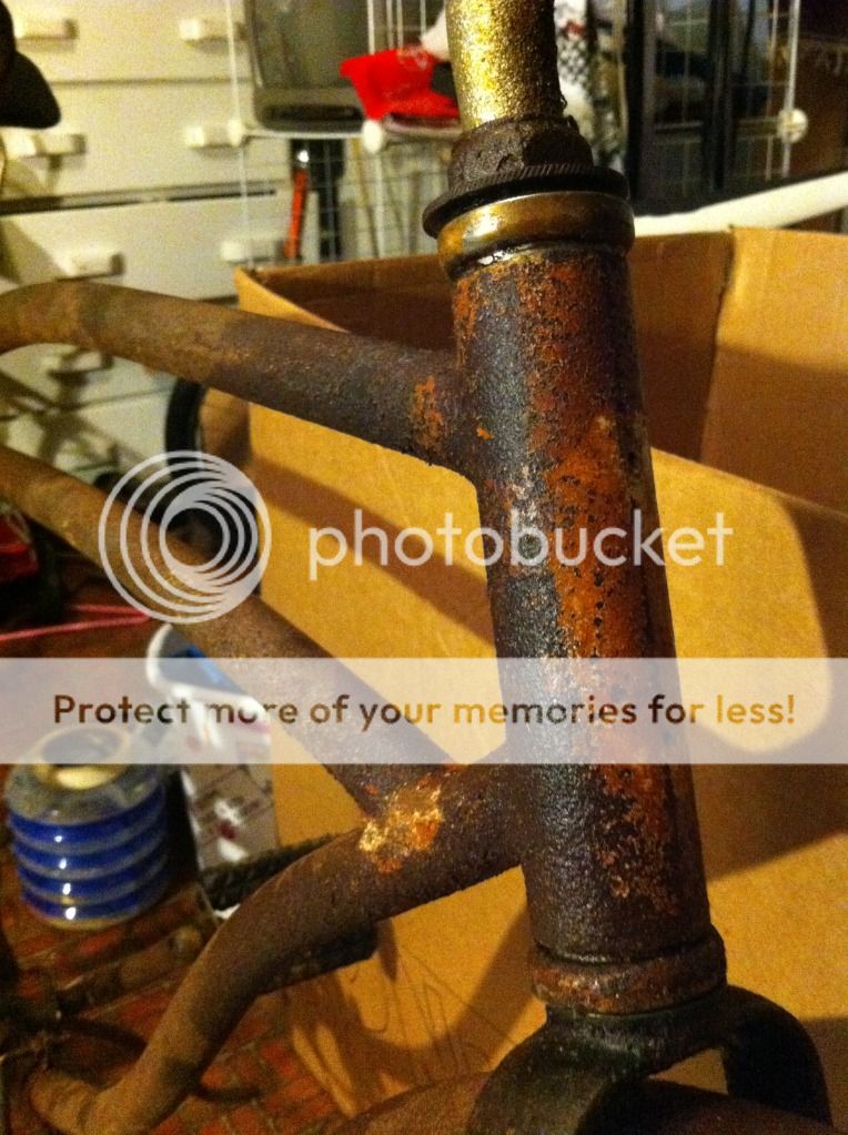

The Original color is red I believe, based on the paint inside the head tube, and bottom bracket. I also belive that it had some kind of creme color that goes from the head tube, back. But on the fork, there is what looks to be original blue paint on the steer tube. Then it someone painted the rest of the frame blue to match the fork. Then someone painted the whole thing black. Then nature took its course and now its mostly surface rust.

Today was a pretty productive day. First, I took the forks off, and apparently they were red originally, and some one painted some blue.
Then I cleaned the whole thing with dish soap and water. (Thanks jalopyjimmy13, and stocksucks For the advice!) Now it's clean :mrgreen:

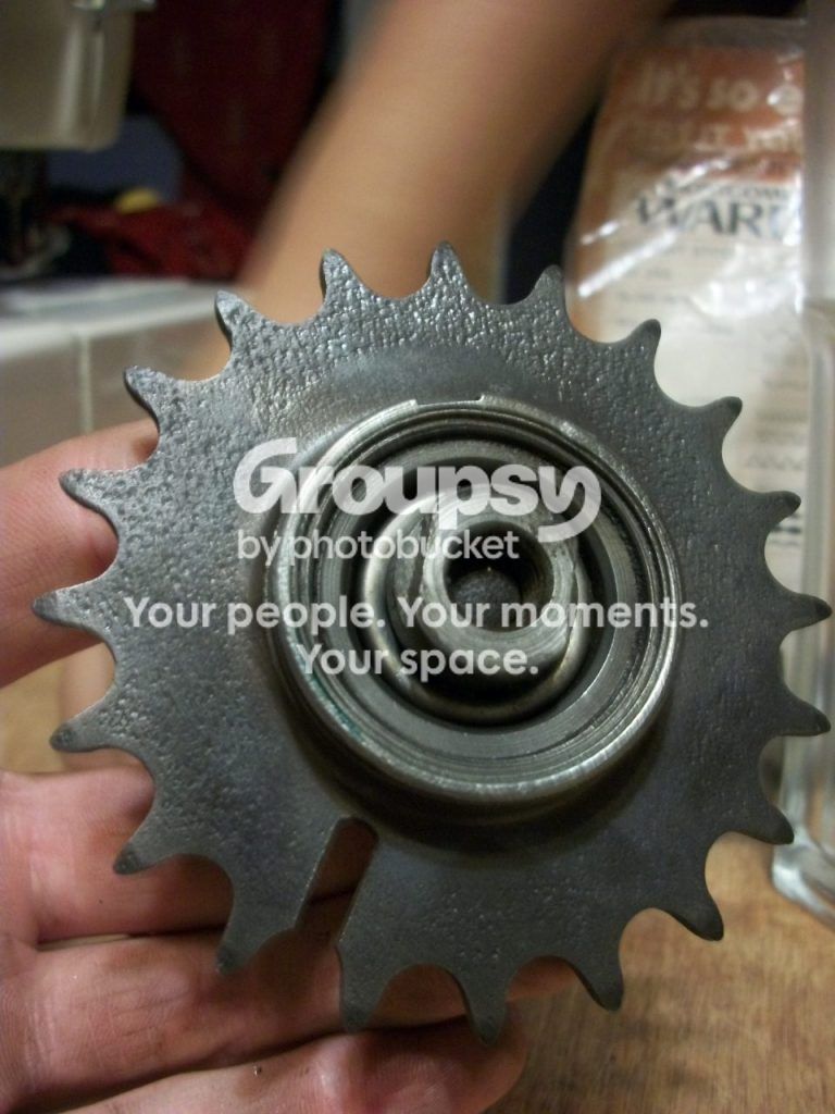

Also, Their is a circular plate on the cog, that is holding the small bearing in. I cant get the small bearing's out at all. Any one know how to get them out?

And I had figured how to get the bearings out. The plate holding them in just popped right out.
