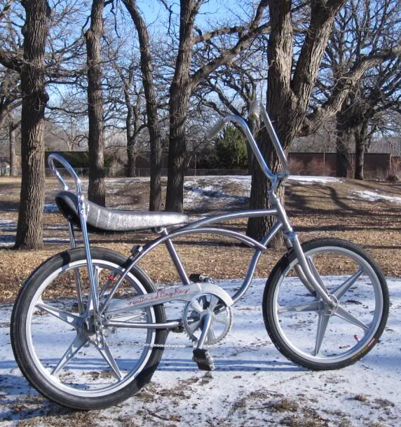

Kinda hinted about this build when making the "Little Guy's" Schwinn sting ray: Mag Ray
viewtopic.php?f=21&t=48122&st=0&sk=t&sd=a&start=15
Wanted a cool muscle bike so I could ride with the little guy and Mag Ray this spring

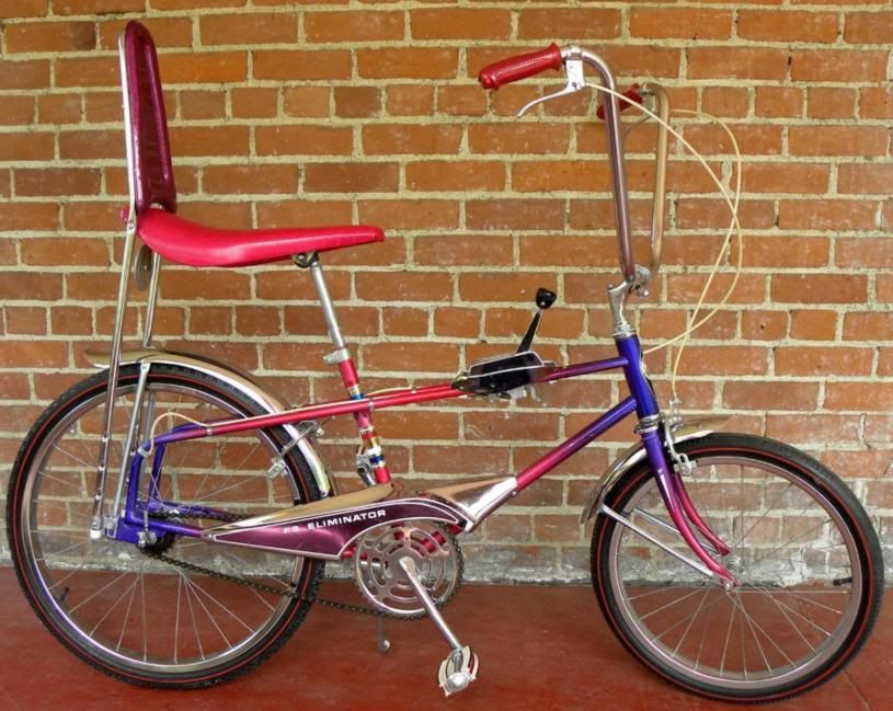

My Dad bought me a new 1970 Murray Eliminator F3 MarkII when I was a 10 years old.
This was my exact bike (thanks for the picture member MurrayEliminator).
When doing Mag Ray, my friend Terry (did the part stripping for free, thanks again) said “Aren’t you going to build a bike like you had?” I said no, they are too small. A side note: when I was 10 years old and Terry was 14, I wouldn’t let him ride my new bike. Didn’t want to let “the big kids” ride it, they might wreck it. :lol: It took about 7 years before he forgave me and we’ve been hanging out ever since (~40 years now).
So now, going to build The Eliminator. Thought about perfect restoration like many of Murray Eliminator’s bike (truly incredible!) but again, a ~ 6foot tall guy can’t (or shouldn’t , lol) ride a 20” inch bike (unless they’re having fun, of course).

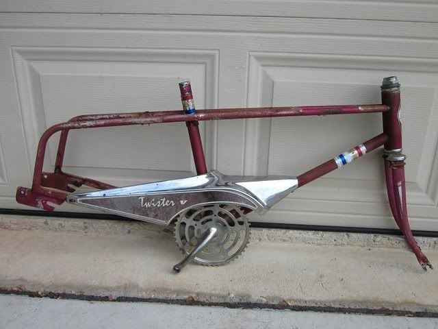

Postby Murray-Eliminator on Mon Jan 16, 2012 6:09 pm
If I'm understanding you correct, you want to put a 24" wheel on the back of that 20" Twister V Frame?... If so without some major mods & frame.welding it won't fit. it's not only the rear drop out that would need to be changed but also the seat tube would need to be lengthened, and the top rail lengthened, you would be better off in the long run to find a 24" Murray Eliminator

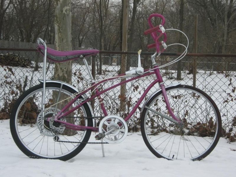

The 24" Elimintors do show up, but they are not as common as the 20" bikes. the most common ones are the western flyer badged bikes called the Wild one" They came in lemon lime fade as a coaster 1 speed, the 3 speed was red to yellow candy fade and the 5 speeds where blue. I still have the frame & fork from this 24" Gambles bike i parted out, but I would need to get 100 out of it because the original paint is in such nice condition.

Postby Murray-Eliminator on Thu Jan 19, 2012 10:15 am
Here are the Pictures of the frame/ Fork. what you see is what you get! It's hard to get the depth and luster of the candy colors in pictures, it looks really nice in person. if your planning on repainting it, you may want to wait on a frame that has trashed paint. You can prob get one for around 50.00! The money in this frame is in the condition of the original paint..Price is $100.00 plus shipping. let me know. Thanks. Eddie. murrayeliminator@yahoo.com

Postby Murray-Eliminator on Thu Jan 19, 2012 12:03 pm
Here are some Pictures showing the differences between the 24" & 20" frames
