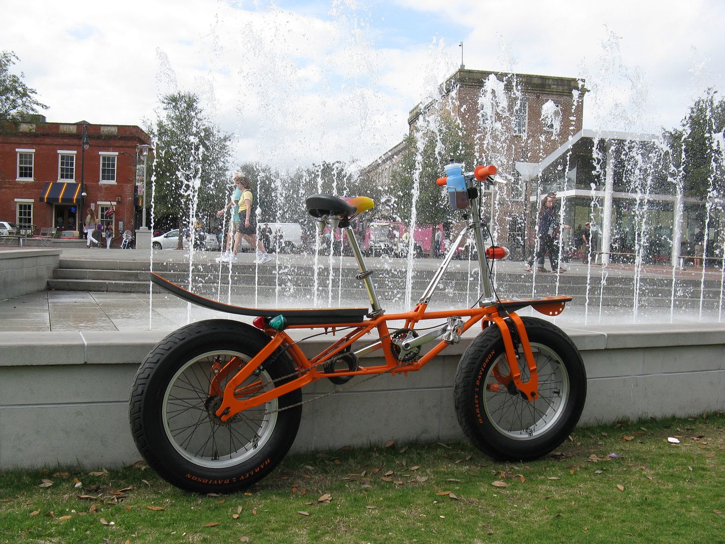

Fugsley - 4/25 Fugsley meets Fat Fink II and Sand Rover

Here is the riding video of my running down one of Savannah's 13 million tourists.
