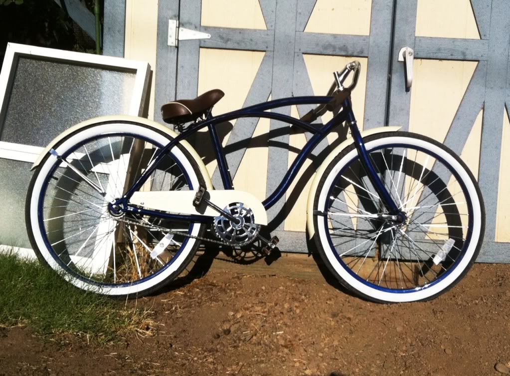

I bought 3 Cranbrooks because they are on sale right now. 1 for my Wife, 1 for her Aunt, and 1 for me. I may need to go get another. addicted? maybe.
My first thought was to see what I could do without cutting or adding any parts. I immediately pulled the decals, flipped the bars, and played around with dropping the seat hardware. I call it the Cranbrook Cutless.

So I broke out the dremel and released the seat clamp from its spot welded perch.
I cut down the seat tube, but I left a little tongue to possibly screw the seat to.
I drilled the seat cross bar and screwed it to where the fender was.
Now the seat lays on the frame in front, but still has some spring in back. I used a tube clamp to secure the front of the seat to the frame using small bolts. The back rubs the tire when I hit a bump, but I have plans for that.
I plan to take this build from mild to wild. Just wait till I christen my HF welder on it! the Cranbrook Cutter is alive!
whadaya think so far? I think that high riser stem has to go.

So, I replaced the sagging seat brace with square tube to keep my rear off the tire.
Home Depot corner braces made great dropout extensions. I plan to hide them with taillights or number plates.
Here's how she sits now. Chain rubbing was fixed with some washers inside the dropouts.
