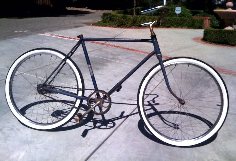

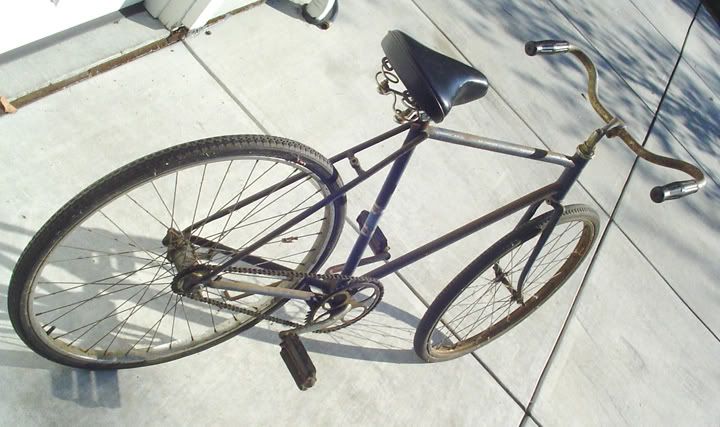

While I'm waiting to finish collecting parts for a couple other builds I thought it would be nice to build something that I don't have to paint. Though I might knock of some of the big rust and clear coat it so the rust doesn't come off on your clothes. I posted this bike in the fresh finds a couple of months ago after I got it off craigslist for a whopping $10. It was pretty ratty and missing most of the original parts, but it was straight and rode ok. I stole the grips and used them on my build off bike. Here's how it look when I first got it. It was made in September of '48.
The wheels were a 26" in back and a 24" in front. They are kind of cool but I've had a pretty nice pair of chrome s-7's with the two speed kickback that I've been dying to put on a bike. Those s-7 tires were a huge pain to get to seat right (you can see in the pics that the aren't setting right). I finally just overinflated them and rode around for a bit, and it seemed to do the job. These frames are also really narrow and the 26x1 3/4" tires barely clear in the front and back. Also sorry for the crappy cell phone pictures, I didn't have any batteries for my camera.
I don't know if these are actually schwinn bars or not but I love the shape. They are almost flat without hardly any rise. The one side is bent in just a bit but should straighten out pretty easily.

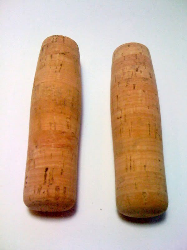

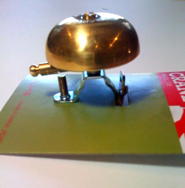

I stopped by Rivendell Bicycle works the other day and picked up a couple cool accessories. The make really nice bikes but they are out of my price range, http://www.rivbike.com/ . I got a set of the cork grips and a nice brass bell.

Postby bighit on Fri Sep 04, 2009 2:30 pm
i love that bell. i have the lever strike.

Postby sensor on Fri Sep 04, 2009 9:11 pm
bars are schwinn.....
the one thing ill warn you about is those forks..if youre planning on ridding that swap them! theyll bend if you look at them wrong :wink:

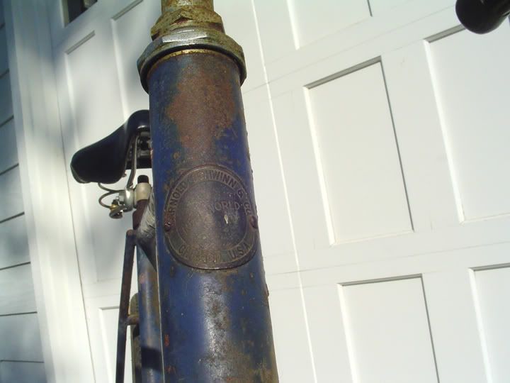

I haven't had much time lately to work on bikes, but I had a couple hours free today to get some work done. A while ago I powerwashed the frame, knocked off all the loose rust and paint, took all the oil off with some lacquer thinner, and then clear coated it. I really like the effect though it might have looked better with satin, but I already had a couple cans of gloss. One of my favorite parts is that you can now see the decal clearly on the down tube. It was kind of hard to photograph though.
I had a super beat up fender that I think came off of an old racer. The entire back section was mangled but there was enough to make a bobbed fender. I stripped the paint off and clear coated the bare metal, and painted the under side red.
When I painted the frame I also noticed that there are two different serial numbers on the bottom bracket. One of them is partly welded under the chain stays. I wonder if it was a mistake or something.

Postby kram on Sat Sep 26, 2009 4:18 pm
Patience Uncle Stretch, I'm getting there :lol: . Last night I got the grips glued on and coated with a couple layers of amber shellac. I stopped by the flea market this morning and for the first time I actually found something that I wanted. I got this old spot light for $2 and thought it would make a good headlight. It was already missing the hand grip part so I just shortened the tube. It's only temporarily mounted for now, but you get the idea.
